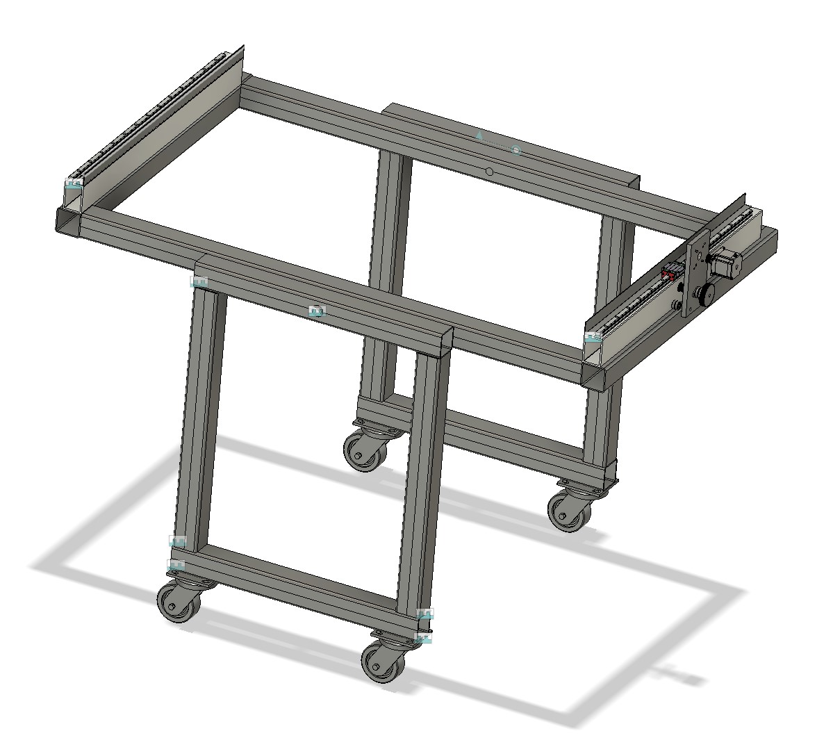

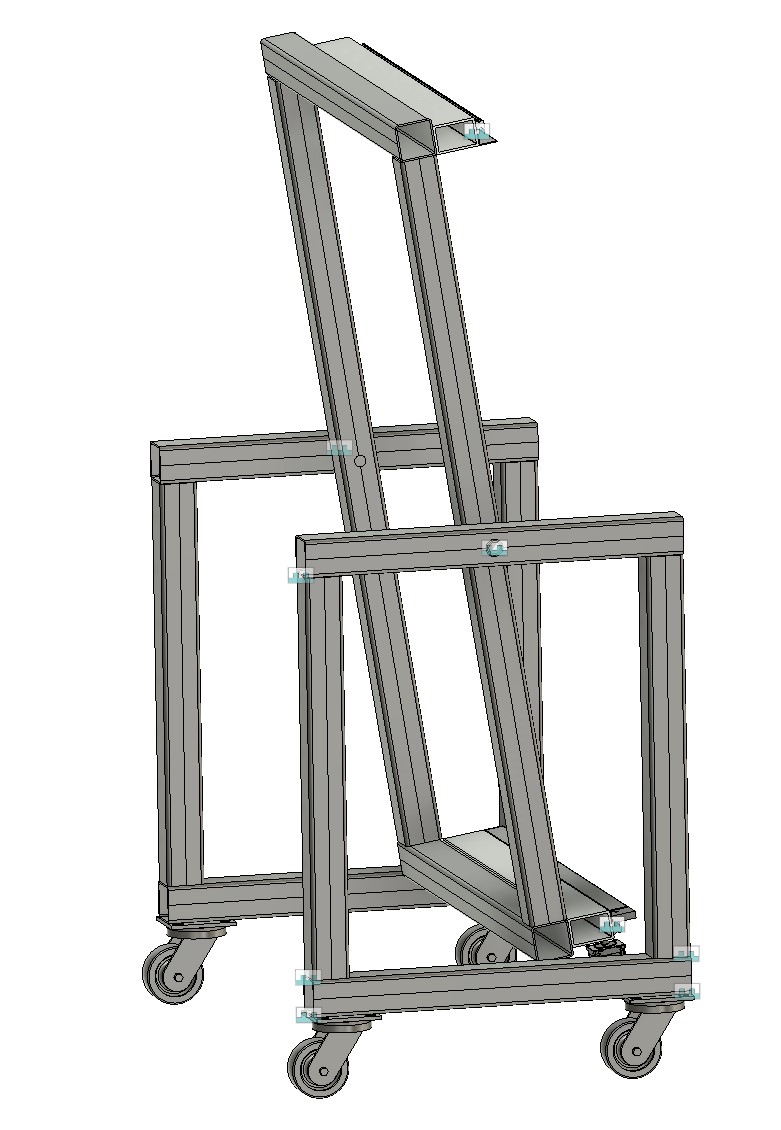

05 Apr 2021 00:15 #204830
by Joco
Replied by Joco on topic "Origami" CNC Plasma Build - folding 1200 x 600mm cut area
Been fighting with design ideas and have come up with this one. I am still working out the best place to put the cross frame supports. But given how things hinge there are limited options.
Overall dimensions are roughly 1500-1600 on the long length where the gantry will span. Gantry will be 75x50mm Aluminium with a 4mm wall.
About 1000mm wide from outside of each support frame. Support frames about 670mm wide.
Steel SHS is 65mm with a 3mm wall. Standard construction stocked size here in NZ. Should be pretty cheap.
View showing "locked" position. There is the potential with this shape to have locking pins at the top outer edges of the support frames.
View showing storage position:
Cheers - J

- Posts: 12156
- Thank you received: 4149
05 Apr 2021 00:29 #204831
Replied by rodw on topic "Origami" CNC Plasma Build - folding 1200 x 600mm cut area
Why not like this?

05 Apr 2021 01:06 #204834
by Joco
I had thought about a vertical table but I have no wall space left to place one. If it was free standing in the slot I plan to use then I will still need it to be on wheels and no more than 1000mm wide. I need it to be on wheels so I can play the reposition dance to work around space limitations.
The other part that looked fiddly to me was when dealing with odd shaped or small cut off parts as the stock to be cut from. This vertical model works super well when doing full or half sheets. Way more fiddly when dealing with small bits. I'm sure doable, just more fiddly. And as a hobby shop I will not be dealing with full/half sheets that often.
Did that do any videos of how they dealt with , say 300mm square bits or a circular offcut that was to be the used to get 3-4 small parts from?
Thanks for the ideas - J.
