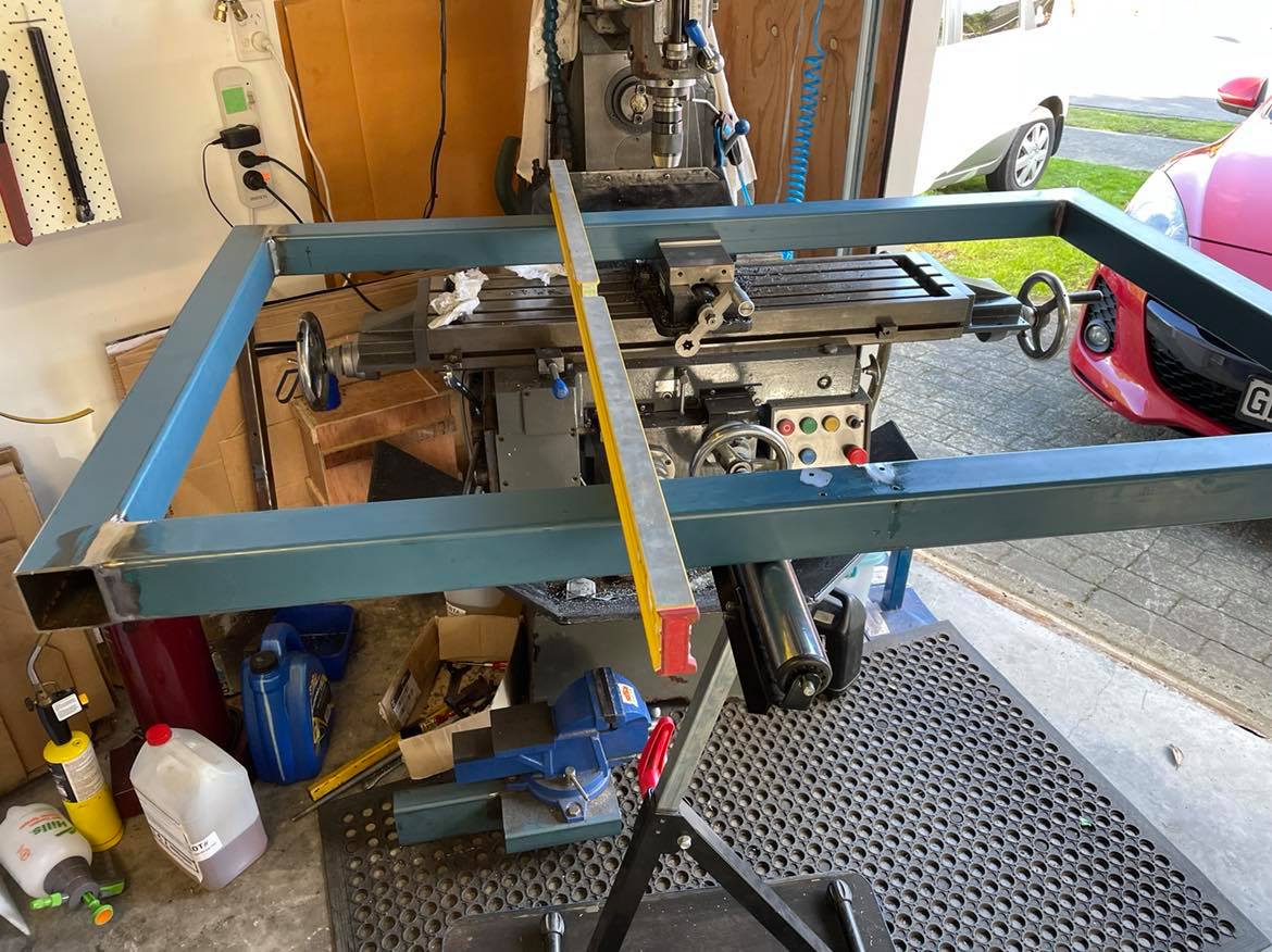

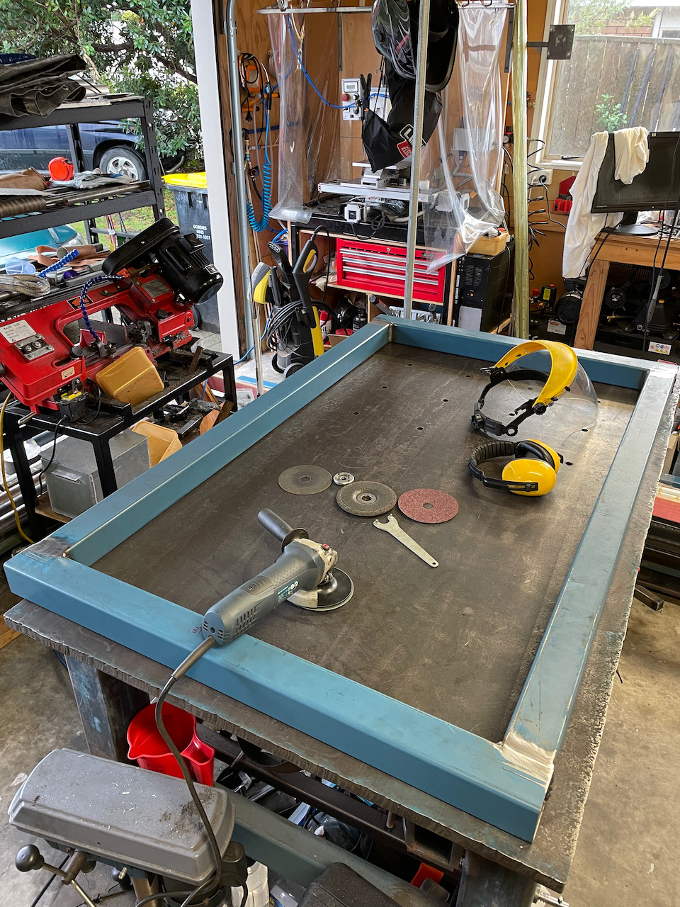

It's Sunday and after much looking, thinking and planning I took the welding plunge on the table frame. The long sections are 1320mm and the ends are 900mm (well really 899mm but close enough). So I welded them out all out then took a 60grit sanding pad and cleaned it all up with this result. And what's more, much to my delight its FLAT and checked square to around 0.5mm from what I can read off the tape measure.
Here is a little video where I test it with the hinge design. I think this could work quite well. Especially as I dial in the centre of gravity.
All in all feeling pretty pleased with the outcome to date.
Cheers - J.

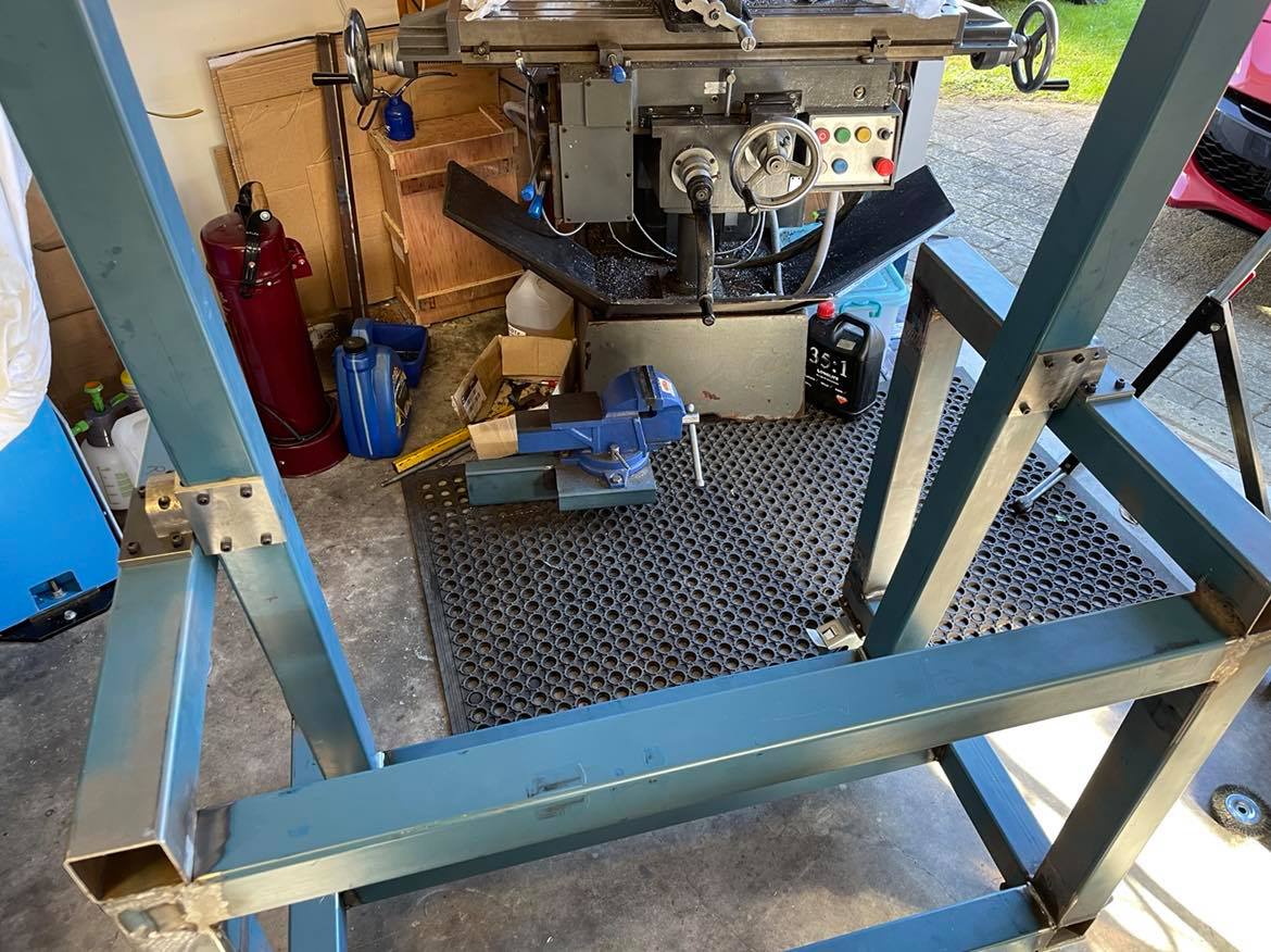

JT - re the axis being perpendicular to each other I guess other than being careful on construction that next part is getting the racking on the X under control. Dual motors and independent homing with adjustable home reference points being key to that exercise?
After getting distracted by a new SLA 3D printer (never had an SLA one before) I got back to the getting the top frame proper mounted. Success after a little drama trying to drill holes with a hand power drill. Ended up having break out the TIG to fix a bung hole that was off position by just enough to be a problem. Then big mill to the rescue!
After that it was easy and while it was on there power tapped the holes. We now have finished hinges and top mounted!
Now there really is no more excuses time to tackle the Y axies linear rails and making the sides to support the X axis. That will allow some motion testing as well. I have the basics of the 7i76e all working on a test bed along with the drivers and motors. I also have all the drive belts and reduction gears for the motors.
Cheers - J.
