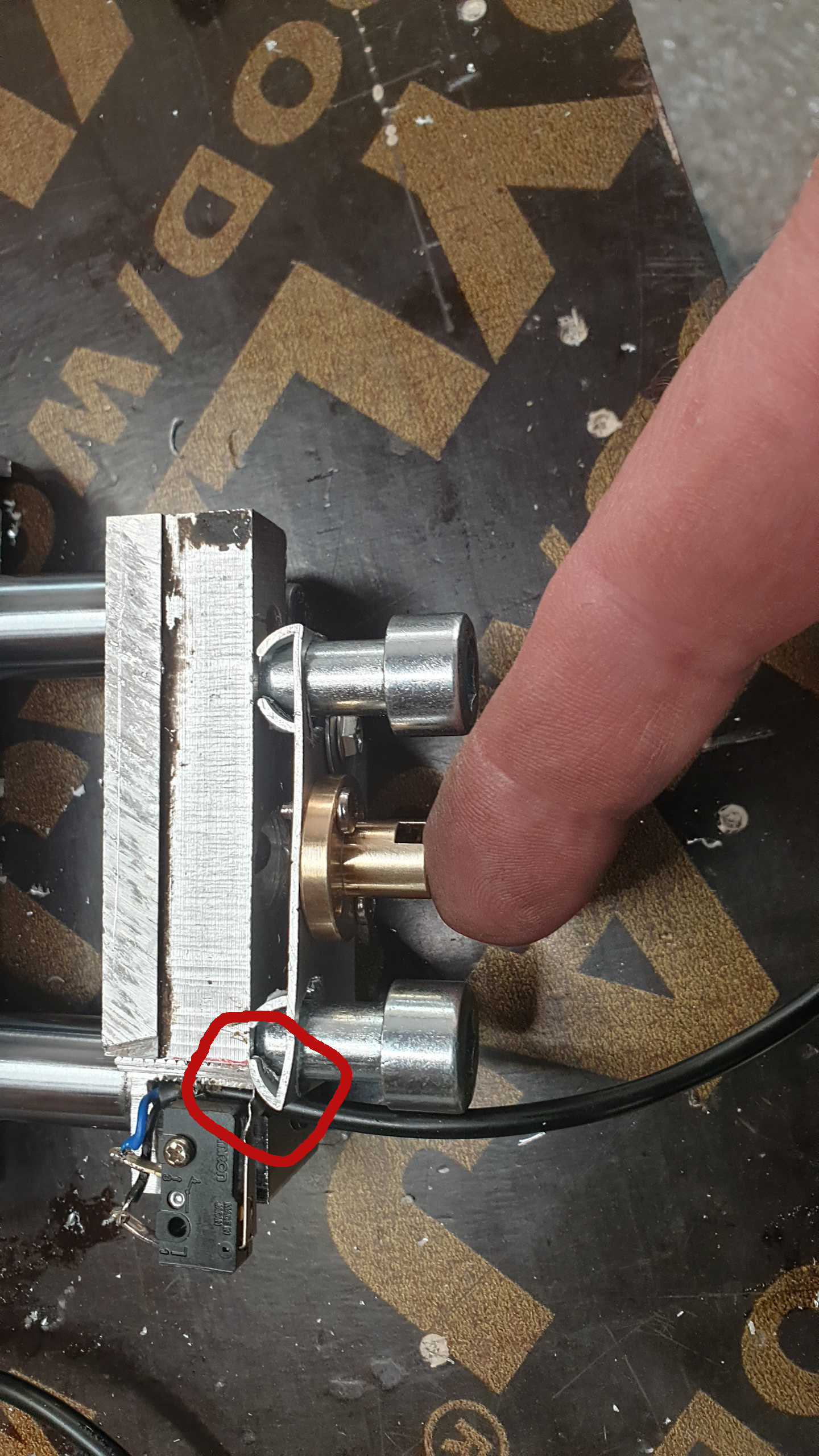

But to get smashed switches doesnt that mean a lot of Z axis crashes? If so how? That would feel to be the sign of some kind of problem?
- Posts: 21959
- Thank you received: 7478
23 Jul 2021 08:58 - 23 Jul 2021 10:52 #215654
Replied by tommylight on topic "Origami" CNC Plasma Build - folding 1200 x 600mm cut area
No problem, user error, namely while setting up the machine and it rams at full speed on the material, or sensor not wired to the input you thought it was, or jogging down while holding shift key ( PlasmaC does not react to float switch while jogging, it should ), etc.
Or after cutting some plates you find a nice design for some lights made out of square tube and forget to raise the probe height, this happened to me several times...
Last edit: 23 Jul 2021 10:52 by tommylight. Reason: Removed QtPlasmaC

23 Jul 2021 20:08 - 23 Jul 2021 20:09 #215711
by BigJohnT
Replied by BigJohnT on topic "Origami" CNC Plasma Build - folding 1200 x 600mm cut area
Last edit: 23 Jul 2021 20:09 by BigJohnT.
The following user(s) said Thank You: Joco, Coachbuilder
- Joco
- Posts: 532
- Thank you received: 327
23 Jul 2021 22:04 - 23 Jul 2021 22:05 #215716
by Joco
Replied by Joco on topic "Origami" CNC Plasma Build - folding 1200 x 600mm cut area
I’m in the process of some tweaks as I plan to move to the roller style micro switch per JTs pic and what Rod had also shown me. Aim is to do a no smash set up per comments.

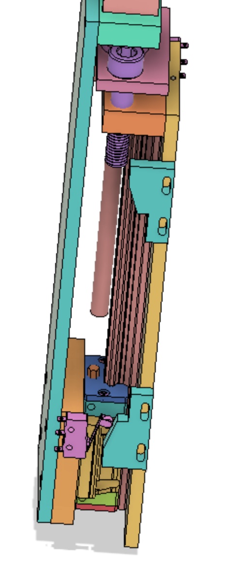

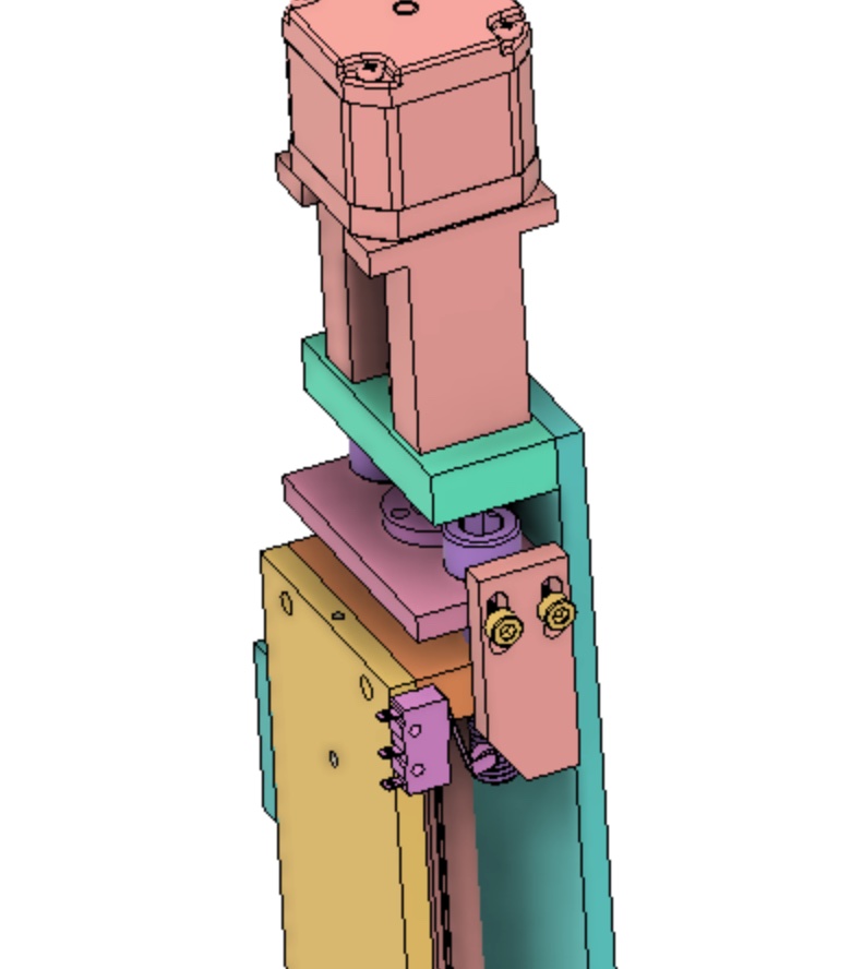

24 Jul 2021 21:35 #215807
by Joco
After some tinkering in CAD have these ideas for float and Z limit switching. Uses "simple" switches that are not able to be smashed and have stops that should be adjustable to fine tune the stop trigger position.
Float switch:
Z Limit Switch:
As an aside I see the forum has a new editor look. But where the heck is the post preview? I'm probably being blind or missing the point somewhere but can not see/find it and really missing the ability to preview a post before hitting submit.
Cheers - J.
Float switch:
Z Limit Switch:
Cheers - J.

- Posts: 21959
24 Jul 2021 23:30 #215818
Much better!
