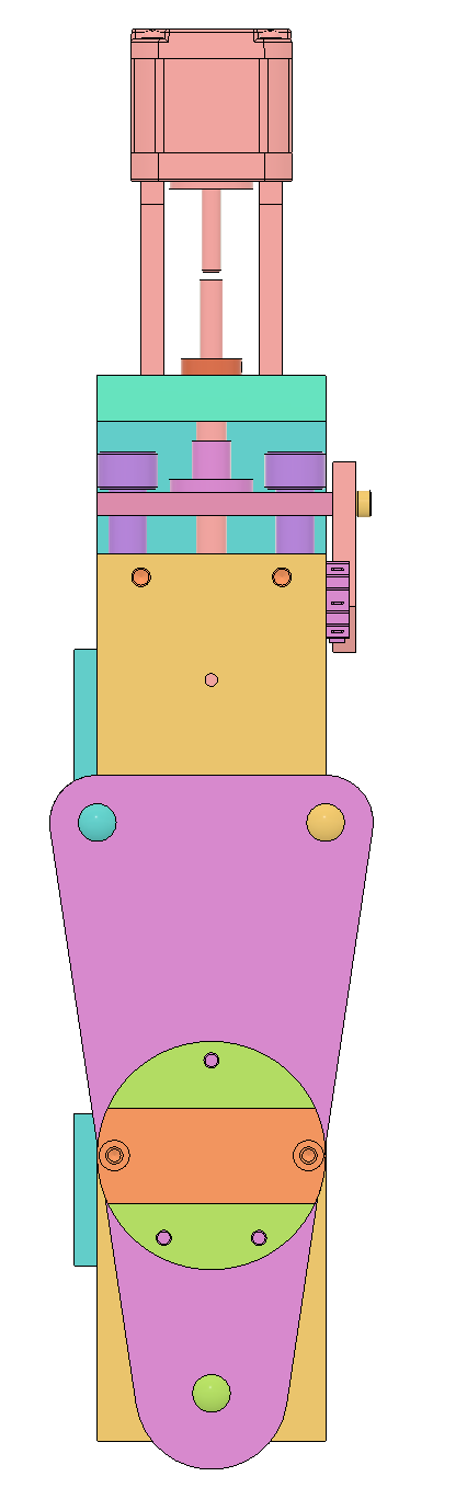

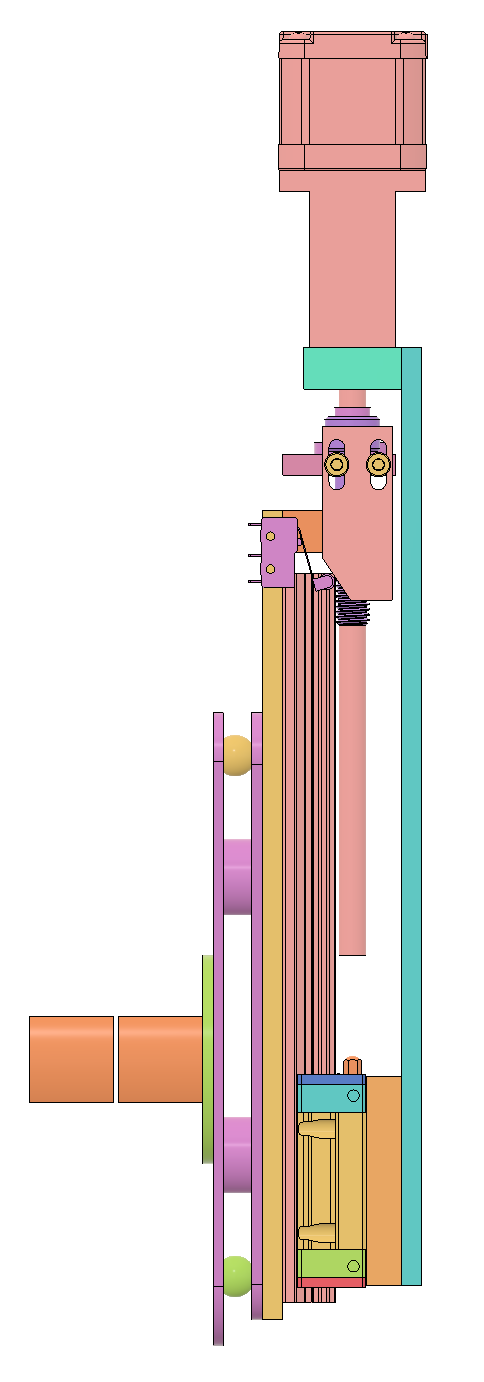

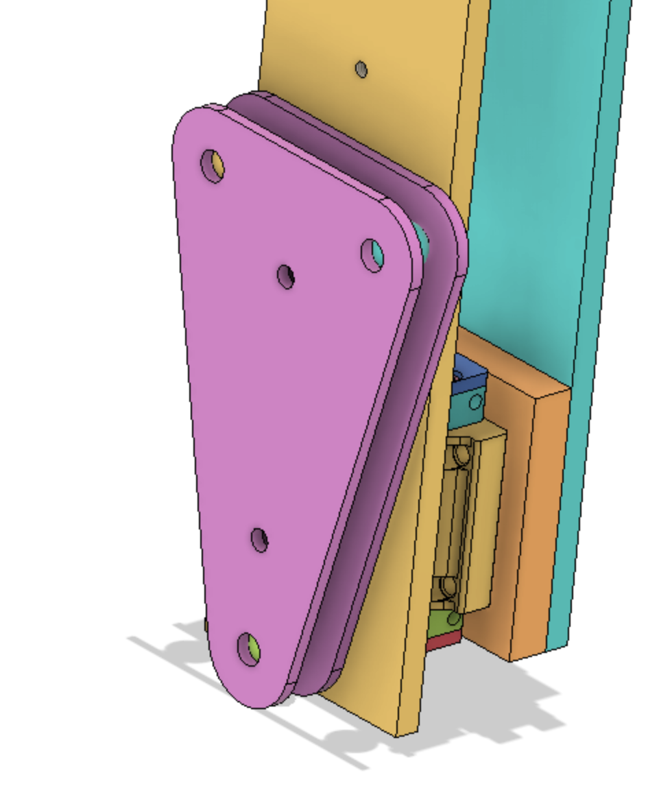

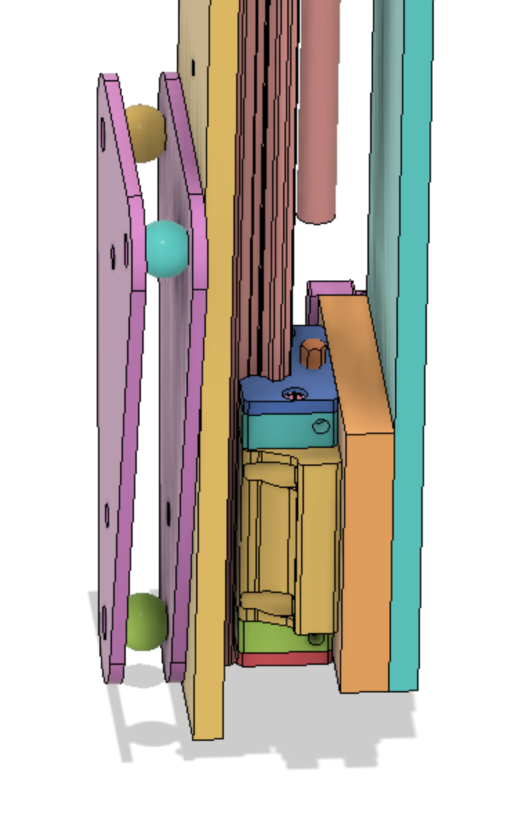

Initial concept for torch breakaway. I'm still working on dimensions and need to check what magnet sizes I can source which will influence the ball bearing sizes etc etc.
This isn't a new design and its concept is based on a design SeanP over on Spider Plasma created.
Anyway, thought I would post what I had at this point.

26 Jul 2021 10:08 #215942
Replied by rodw on topic "Origami" CNC Plasma Build - folding 1200 x 600mm cut area
I like it!
- Posts: 21813
- Thank you received: 7449
26 Jul 2021 10:34 #215948
Replied by tommylight on topic "Origami" CNC Plasma Build - folding 1200 x 600mm cut area
+1I like it!

I think I might have a had a brain wave or brain fart. Will work on an idea and post it but I "think" I can simplify this and get easier reposioning for bevel cust.
