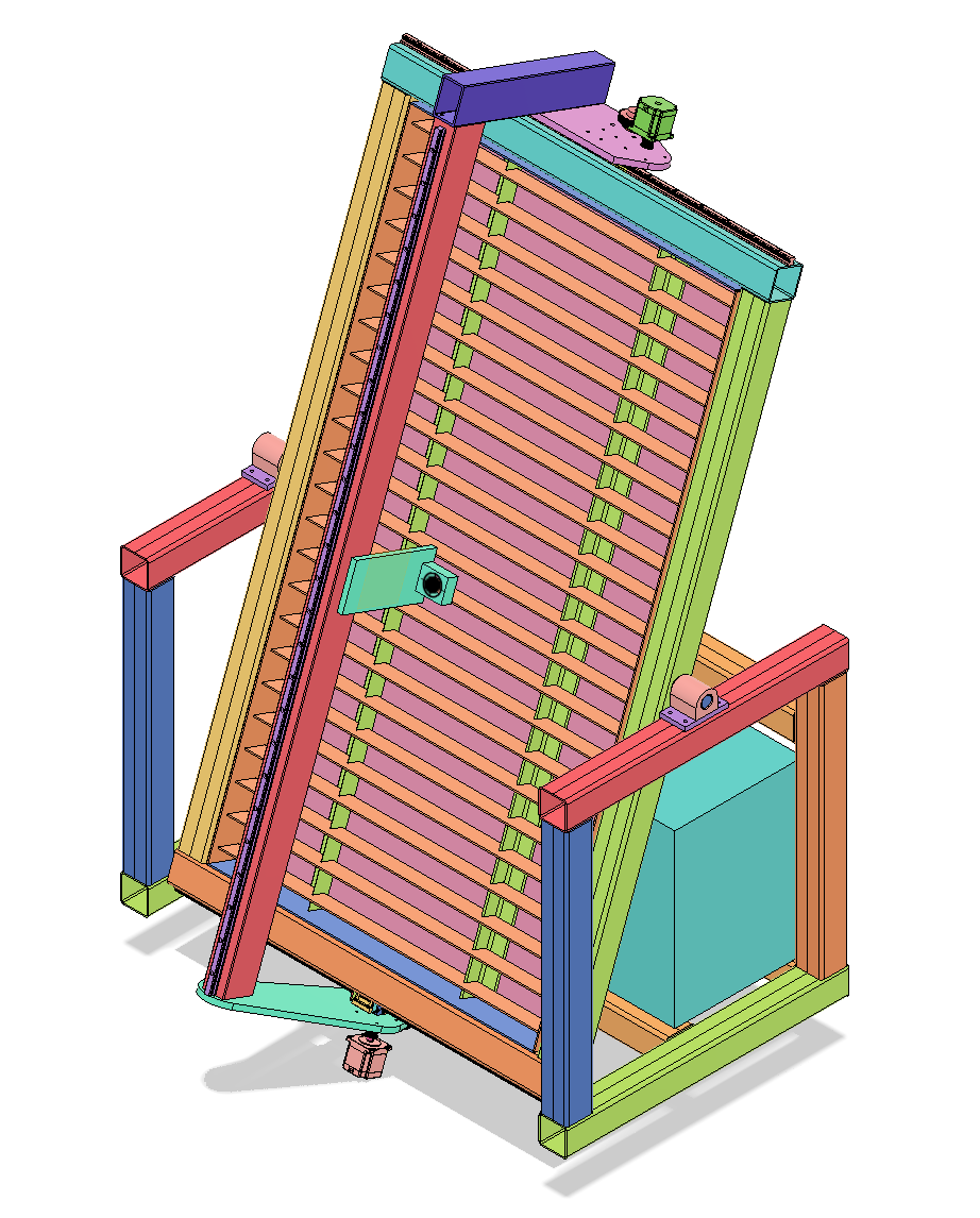

Have read about them on a few commercial sites I can see there is quite a divided opinion with no real clear winner. However I think your last comment does hit the nail on the head "so much easier". This is my first plasma build I'm already biting off a bit. So tending to head down the well trodden path of those who have gone before AND trying to keep things simple(ish).
So will stick with the fold/pivot idea for this build. Take the compromises that come with that, build a water table for it with an ability to fill/empty from a small "drum" under low psi. Heck that could even be controlled via lcnc. With the 7i76e I am going to be spoiled for IO pins.
Will try and refine my existing table design a bit. It feels a bit like tank engineering at the moment.
Rod - is there is reasonably basic math or online calcs to determine how much base width I need on the wheels for stability when table is vertical? Trying to work out how narrow a base I can get away with. I can always add some outrigger support when the table is flat for cutting.

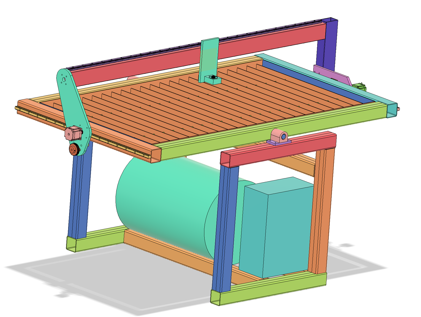

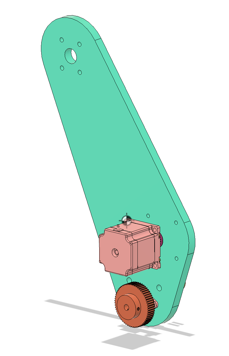

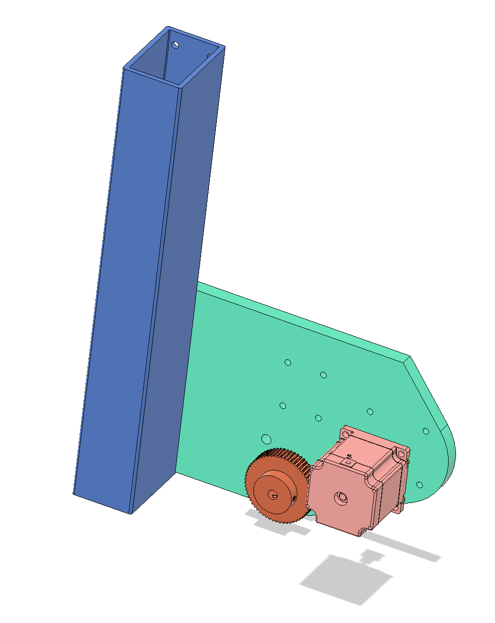

Well I have been working away on plans and started cutting metal and beginning to weld things together. Along with making mistakes and having to unweld things - that is another story with some supporting language that really isn't printable.
Anyway attached are some cad screen shots of the design. This is the overall table. It's not complete as yet but the key features are in place and checked so that I can start construction of the frames.
I have two potential gantry side supports that I am debating with myself over. The more elegant one made from a single 12mm piece will be a little more challenging to make given the size of it. I think I can just fit it on my small cnc mill. Or will have to do "old school" on the big manual mill.
The second option is two piece construction. A 12mm part screwed to a piece of 75x50x4mm RHS (the same as used on the gantry span). Given the sizes I can easily do the 12mm flat on the cnc mill.
I think they will both do the same job but one clearly looks a lot more elegant than the other. However if there are advantages from an structural or adjustability angle between them that I am not aware of then keen for views.
Or of someone has a better design they can point me to? That also would be valuable.
Cheers - J.

12 Apr 2021 00:27 #205688
Replied by rodw on topic "Origami" CNC Plasma Build - folding 1200 x 600mm cut area
For a part like that gantry end, I would just get it laser cut and tap any holes when the part comes back (What I did for the Spaceship!) They should be able to cut tap ready holes for M6. Smaller than that, they can etch the position and you need to drill.
I think the green part is the way to go.

12 Apr 2021 22:02 #205739
Replied by andypugh on topic "Origami" CNC Plasma Build - folding 1200 x 600mm cut area
Would the motor be safer from damage on the other side of the uprights? (well, damage from the floor, or items on the floor) it is more likely to be damaged by the work or the plasma.

12 Apr 2021 22:33 #205746
by Joco
It's a good question Andy and one I flip-flopped on quite a bit. I settle on having the motors on the outside so as to keep them away from any crap being spat out buy the torch. The intention is to create sheet metal or high impact plastic covers over those ends to protect that assembly from being knocked and general air borne grimme. This external model along with protective covers is a pattern I have seen used elsewhere. For some reason I think tommylight has done something along these lines.
As a further "protection" when the machine is in its stored state there will be a piece of equipment (on wheels) sitting in front of it that will act as a buffer for that gantry end assembly from it getting accidentally knocked. But with this style of machine where I can't put it fully vertical there is always some risks involved. However ... I have worked out that if I fabricated a custom water chamber I could make a shape that could get the volume needed while allowing the table to tilt to the vertical another 5-10 degrees. That small amount will bring things that much further into the bounds of the frame and further reduce the risk of things getting knocked. It might mean I need to add some extra spacing to the wheels I have. They have a finished working height of 130mm.
Cheers - J.

13 Apr 2021 02:32 #205759
by Joco
Replied by Joco on topic "Origami" CNC Plasma Build - folding 1200 x 600mm cut area
Thanks Tommy. I have remodelled to accomodate 200mm height. I have also done some adjusting to see what I can do to be able to store the table fully vertical. If I do that then with a 200mm gantry (table top to bottom of gantry) eveything JUST fits inside the boundary of the frame. Assuming I park the X axis at the top so torch and cables are out of the way. While not necessary it minimises the footprint to be just the base size (approx 660mm x 1040mm). It does create some other challenges but what the heck, where would life be without some challenges.
On the ethernet front, yup undersatnd one at a time. And for my shop that is just fine. I do have spare Core2 machines that have good latency so its not like I have to do it. Just good to know it is an option.
