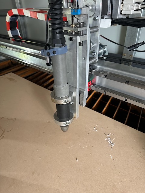

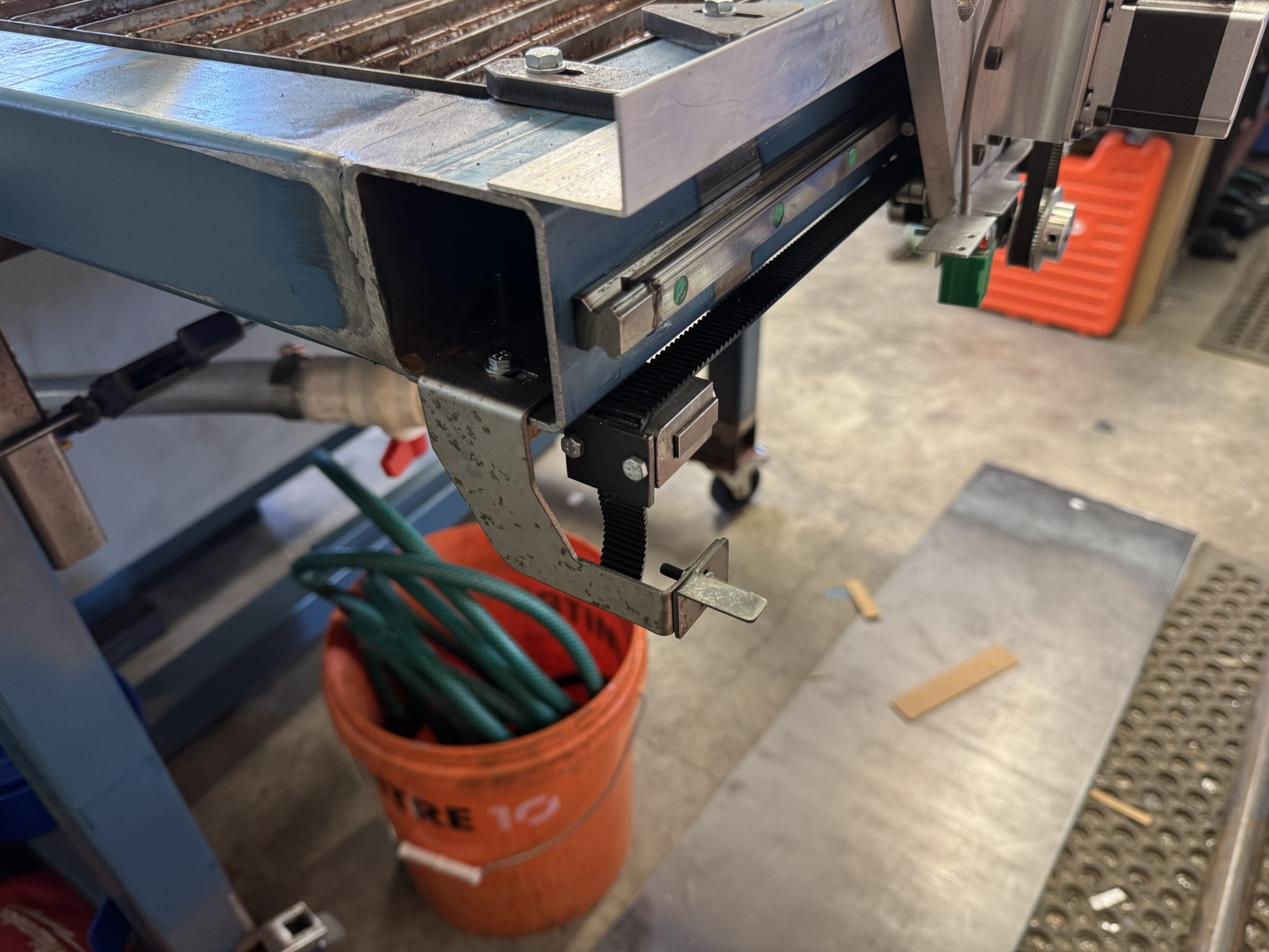

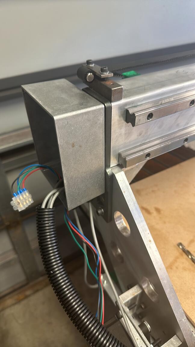

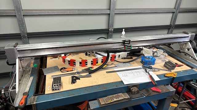

After some initial cutting and some stress testing I conluded that the gantry needed dual linear rails. On HGR15 rail the bearings are pretty good but they are weakest on twist around the length of the rail. i.e. if you look down the length of the rail and twist the bearing left or tight on the axis the is way way way more movement then when you are looking at the rail face on (such that the moiunting holes are all facing you) and you then try and twist the bearing block left/right (good luck moving it).
This meant that when doing "high" accelerations and movement speeds it was easy to create wobble in the torch. SO two rails will lock that right down. And it does. So design advice to anyone else doing this, either consider 25mm rail (it's propbably going to better in that direction) or dual 15mms.
A few pics attached. Once things are all back together I will retest and post results.
Cheers - J.

26 Nov 2023 08:00 #286532
by Joco
Replied by Joco on topic "Origami" CNC Plasma Build - folding 1200 x 600mm cut area
This is a short video I did checking the performance of the new dual linear rails on the gantry. This is a pure motion check no cutting involved.
Acceleration is 2500mm/s^2 and feed speeds are 7000mm/min. So its pretty quick. Rapids are at 240000mm/min.
Overall observations is it is significantly more ridgid than before. I was constrained to accelerations of 1000mm/s^2 as anything over that you could really see the torch wobbling and vibrating on the sudden direction changes. If I push to 3000mm/s^2 then the inertia in the stepper motors on the x-carriage start to cause twist in the gantry beam and so some vibration begins.
Cheers - J.

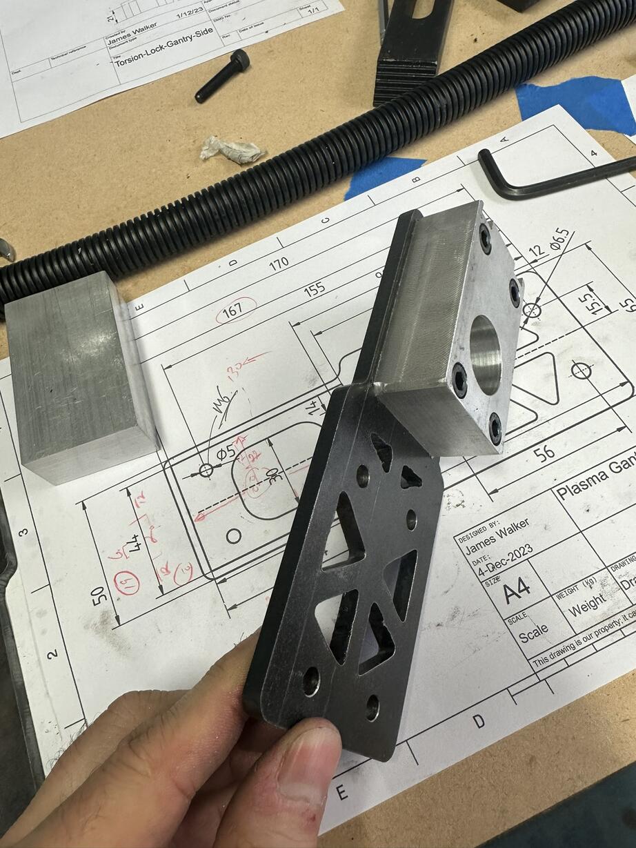

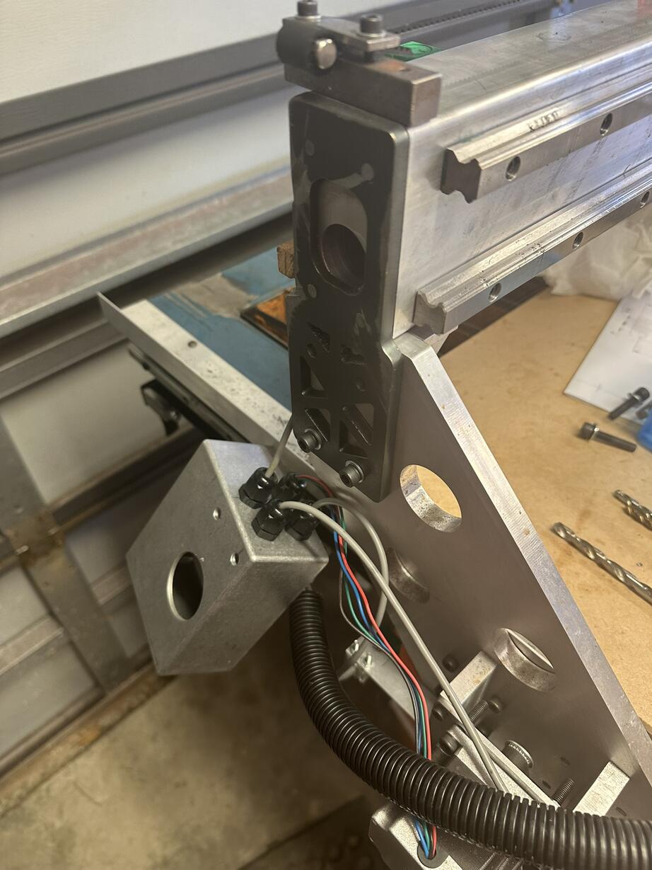

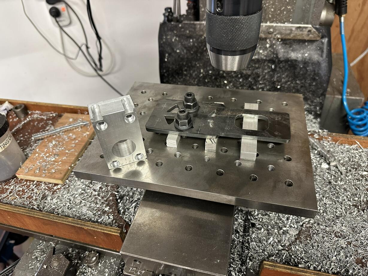

In an effort to improve the torsional strength on the gantry beam I designed these brackets that have a block which pushes into the gantry about 23mm and is a tap-in fit. The bracket is 6mm steel and were cut out on the plasma table.
The video of the items being cut along with a spanner for a the 45mm nut on washing basin waste water fittings.

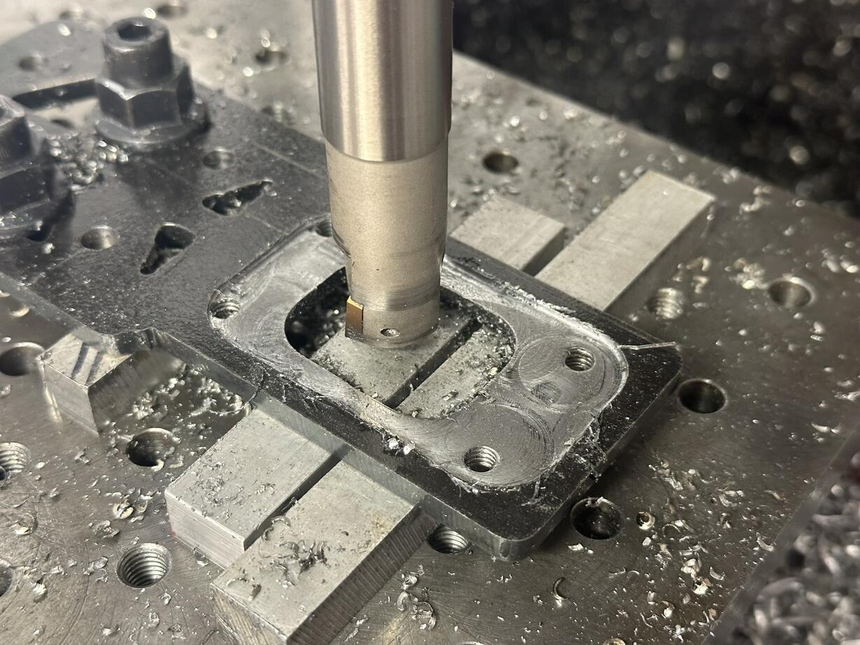

Setup on the manual mill using a small fixture table.

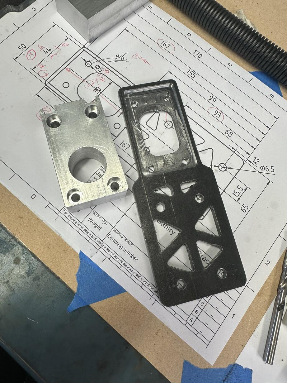

Roughing out the block insert using a 20mm insert mill. This deals with the hard edge left by the plasma cut. Transitioned to a 6mm carbide endmill to bring to final dimensions and get down to a 3mm radius on the corners.
Parts done and ready for assembly.
Installed into gantry and ready for stiffness checks.
Stiffness checks dry run using 3000mm/s^2 and feeds of 8000mm/min.
Cheers - J.

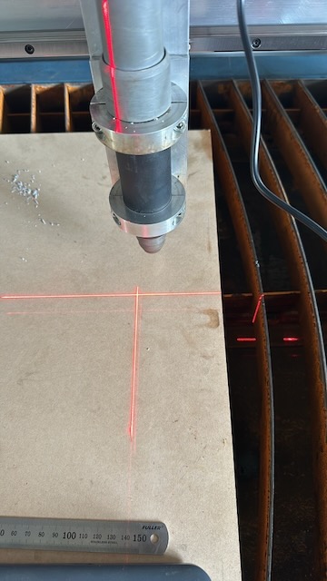

I setup ohmic sensing on shielded and unshielded consumables. As I was not able to easily source a machine shield for the PTM80 torch I got a gouging shield, mount it in the lathe and turned the end down so there as 0.5mm gap back to the nozzle. I did a similar approach to the hand torch standoff. I had to make a mandrel to mount it on and clamp with a hose clamp. But once that was done turning it down was easy.
Next I made a "fence" on X0 (X is my long axis compared to the YY one). This was done using 3adjustable triangles which i then aligned using a DTI. Accurate to within 0.02mm over the whole travel.

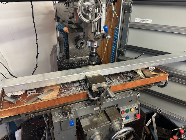

Final update is some work I have been doing to enhance the YY axis travel. My machine had been 610 x 1240mm on YYX config. This allowed for indexing full 2400x1200 sheets through the machine even though I did not have room for a machine of that size (hence the fence). But I wanted to try and improce on the YY travel. I have figured out how to get it to 700mm. Stage 1 gets me to 690mm and these new over travel flags support that extended travel.
Finally the machine making parts for the machine:
Cheers - J.
