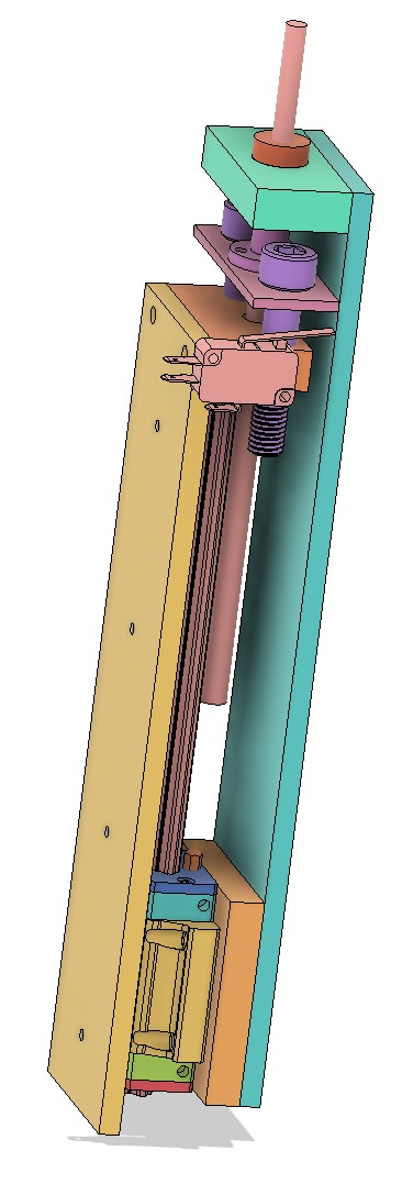

21 Jul 2021 06:07 #215459
by Joco
Replied by Joco on topic "Origami" CNC Plasma Build - folding 1200 x 600mm cut area
Taking on Tommy's advice and inspiration from his Z design I have been redisgining the Z assembly. This design is 46mm from front to back.It has 130mm of travel and the total height of of the backplate is 270mm. Amount of travel on the float switch is probaly around 8mm at the point of trigger. Total physical travel is 13mm.
Interested in views, improvements or potential gotchas.
Cheers - James.
Cheers - James.

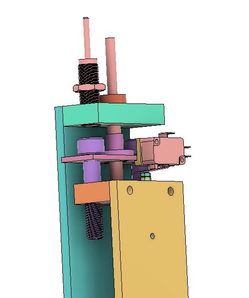

21 Jul 2021 09:00 #215465
Replied by rodw on topic "Origami" CNC Plasma Build - folding 1200 x 600mm cut area
Looks good. The only thing to watch is to be able to adjust the float switch hysteresis but I guess you can adjust that with the bolts.
I added an adjustment screw so the float switch just moved the minimum amount to trigger for speed.

21 Jul 2021 09:08 #215469
Replied by tommylight on topic "Origami" CNC Plasma Build - folding 1200 x 600mm cut area
Make the switch location so that the plate triggering it rests on the supporting plate when pressed down, not on the switch.
Saves some switches!

21 Jul 2021 09:14 #215470
Also, I learnt the hard way, the switch should be on the fixed part, not the moving part so the wires are not flexing all the time...
Try and design it so the switch body is safely out of the way so it can't be smashed...

21 Jul 2021 10:00 #215474
by Joco
Rod - with this design I'm not too sure how I can avoid a flexing wire situation. Definately need to get the switch into a safe spot. But all good refinements to look at after this first cut.
If the part the acme screw nut is bolted to was a piece of angle iron, it would be an ideal spot for a switch with minimal wire flex...
