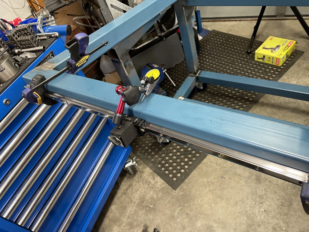

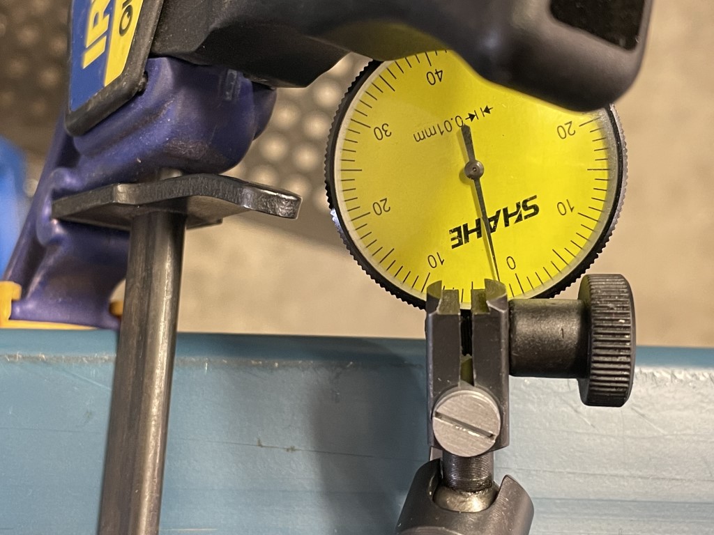

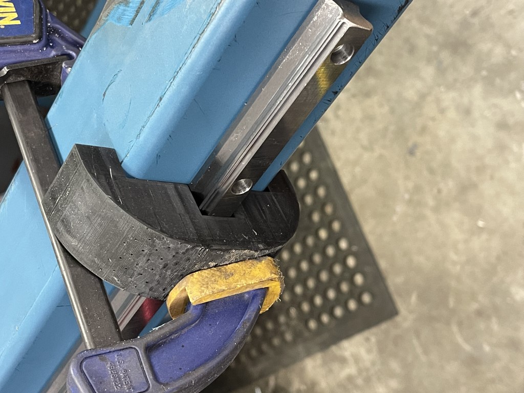

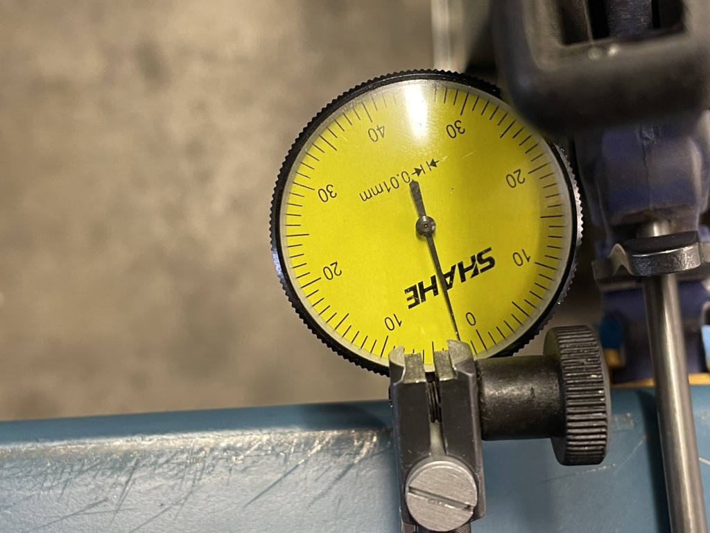

18 Jul 2021 00:29 #215191 by Joco
 A little progress this weekend.  Got the Y axis linear rails cut in between the rain.  Also printed these aignment jogs that I was shown bby a friend that he used on his hypercude 3d printer.  So after some looong print time as these are significantly bigger I have two.  And they work a treat. Instant alignment to within sub 0.06mm.
Mounted rail
An alignment bracket
Checking how accurate it is to top of rail
Setting middle of rail to zero as reference point
Right then Left tavel check.   Pretty good at 0.02mm from zero.  In sweeping across the length and bearing in mind this is hot rolled steel with primer on it there is 0.05 to 0.06 of variation.  I would say that is pretty dang good given how this is all being put together.
I think a pretty good start to getting these rails lined up and ultimately in place.
Cheers - James.

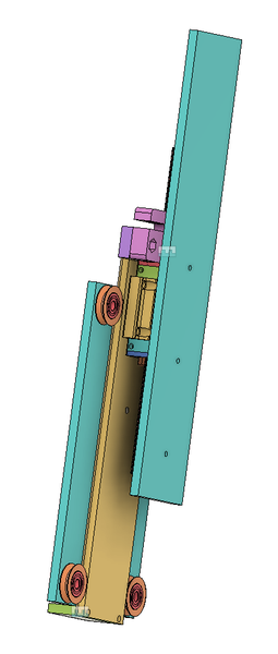

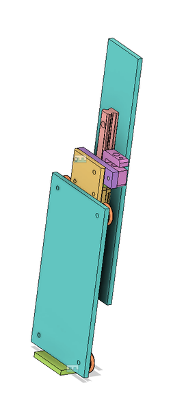

18 Jul 2021 10:35 #215219 by Joco
Here are some draft images of a Z axis design.  I am trying to make as low profile as I can manage with components that are either readily available or not too challenging to create on a lathe or mill.
Cheers.

18 Jul 2021 16:29 #215235 by tommylight
Check my Z build here, one set of rails needed for floating head is done with about 7 euro in material and it works perfectly fine:
 forum.linuxcnc.org/show-your-stuff/38547...plasma-build?start=0
