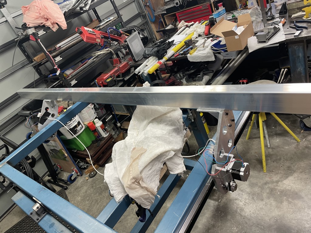

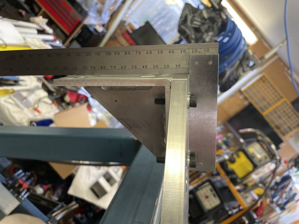

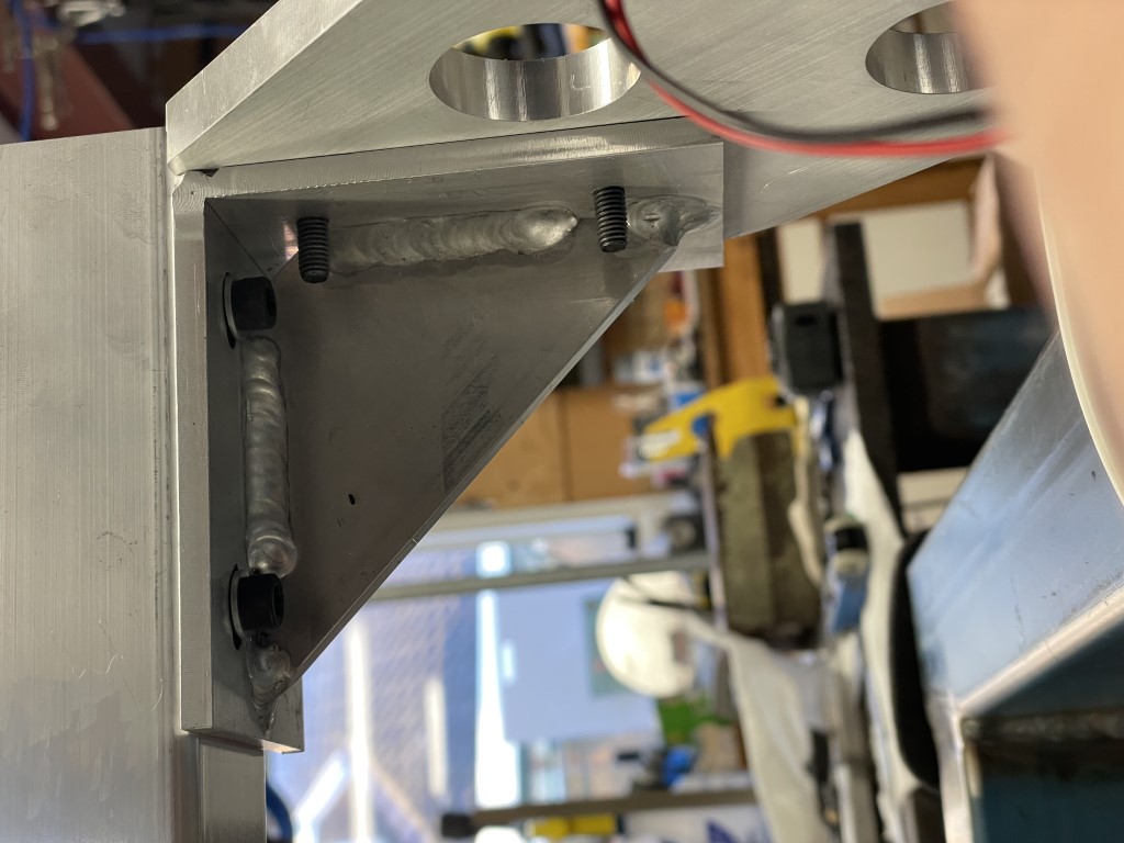

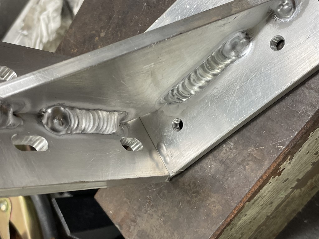

So a little update.
Got the brackets all welded up. Also went back and added some more weld in to get closer to what a proper fillet on 6mm should be.
Then after maching things square the first one mounted with a sqaure on it. Think its looking ok.
I couldn't resist just laying the raw gantry beam on the new mounts. Might need a little trim.
Unfortunately not going to get any progress this weekend as have to head north to parents. But the next thing of real note is going to be the Z/X assembly. Will get into that next week.
Cheers - James.

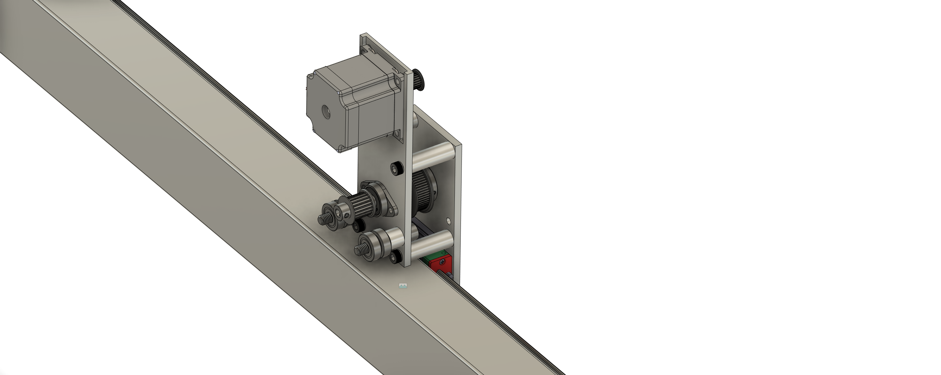

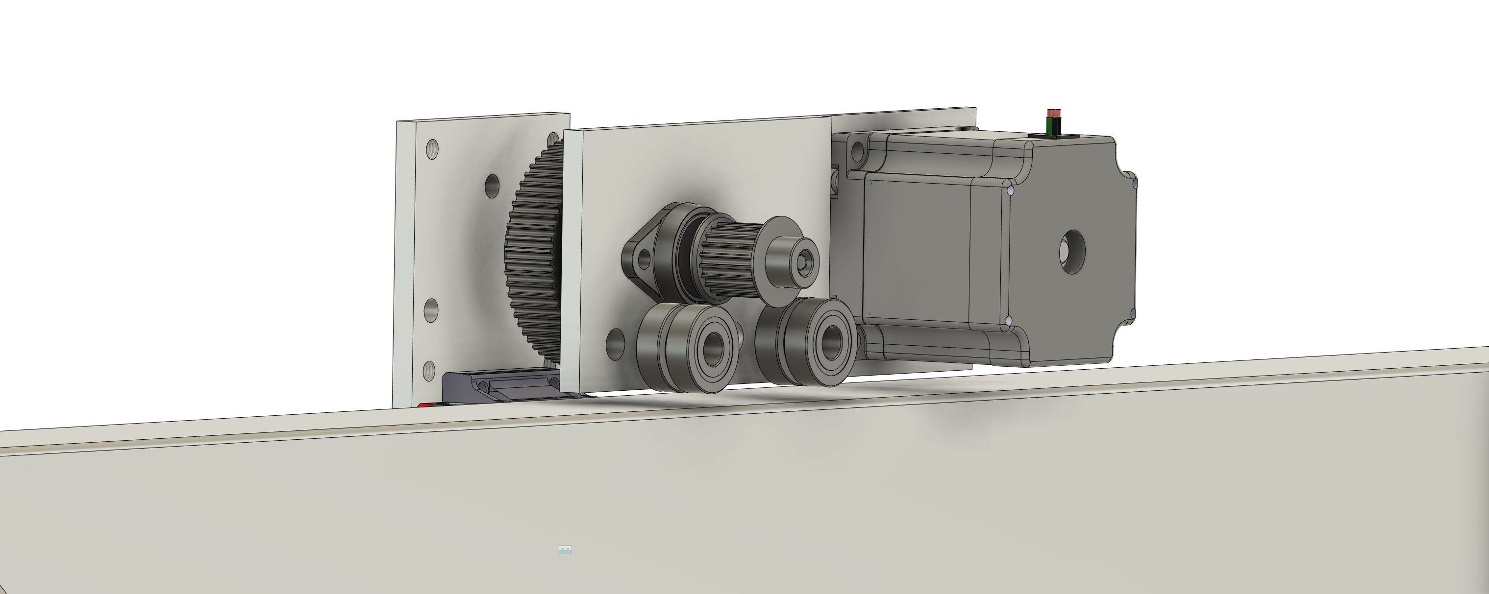

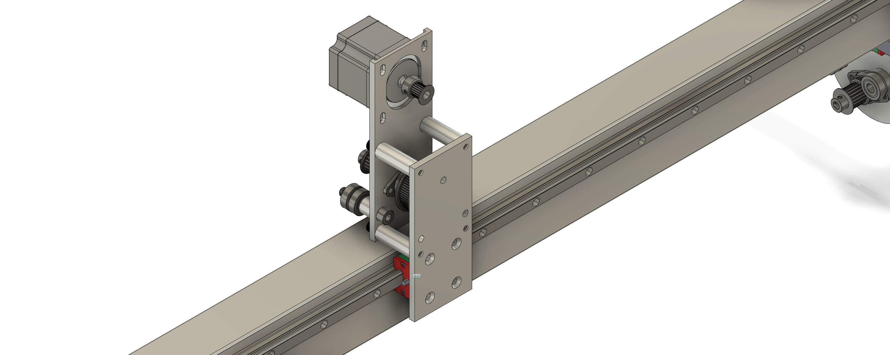

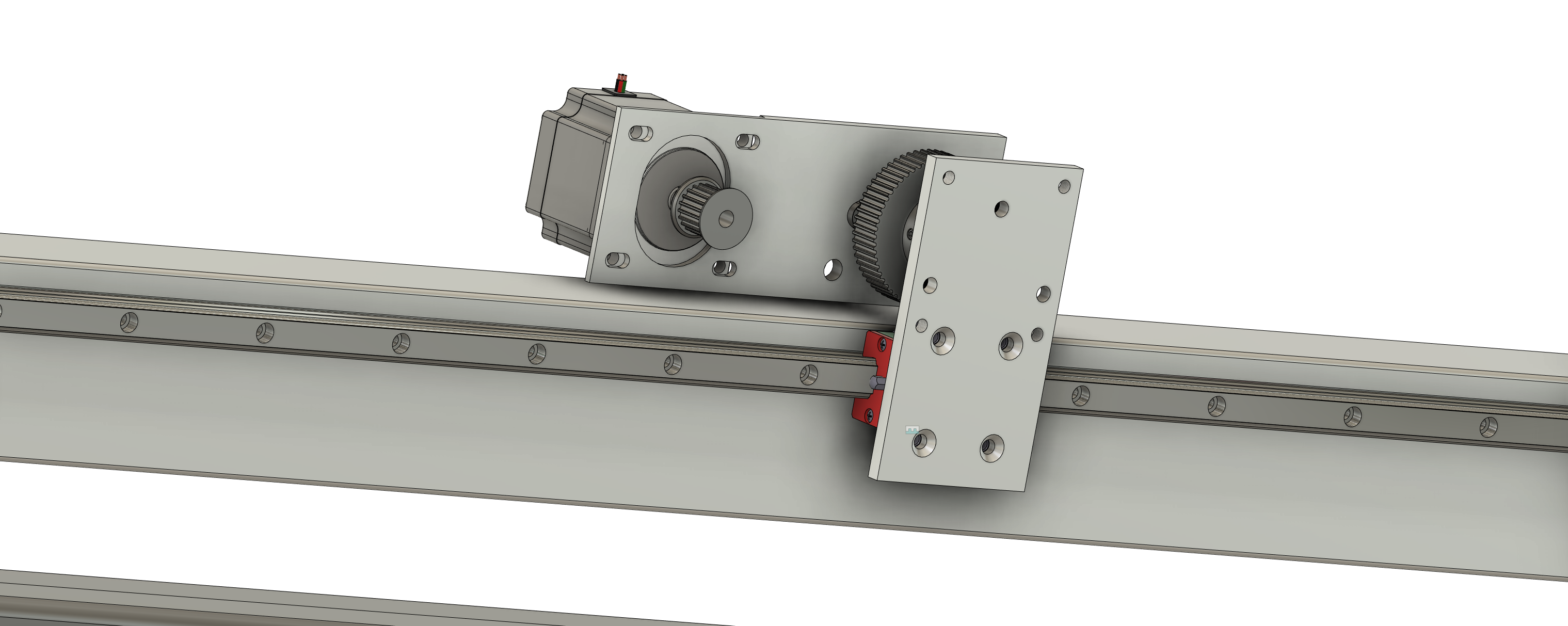

Update and design thinking.
Got the gantry cut, trimmed the ends square on the mill and drilled/tapped the mounting holes on mill at the same time. Need to get some shorter screws. These are getting a bit long. On the plus side it has proven that the brackets have turned out rather well.
After seeing Tommylight's X axis belt design and it confirming some rough ideas I started converting things into CAD. This helps me get dimensions right first time and get a better feel for what the assembly will look like.
So here is an early idea for an X axis drive system using belts. Still rough and still debating how to secure things together. Obviously there is the potential to leave things in the current orientation or to move it 90deg shifting the motor higher above the gantry and in line with the Z axis.
Improvements/ideas welcome. Also any abservations on limitations and things to watch out for are welcome.
Cheers - James.

02 Oct 2021 23:28 #222063
Replied by tommylight on topic "Origami" CNC Plasma Build - folding 1200 x 600mm cut area
That works just fine and i like the idlers being very near the beam and from above so the belt is safer from accidental grabs. Also if later you want to add another belt glued to the beam and do "servo belt" style motion, it is already set up!
Do you have the pulleys already? I buy them from "ideaformer1" on ebay, never had issues and you can get 60T + 20T + 200mm GT2 belt for something like 5$ a set. Can't beat that!

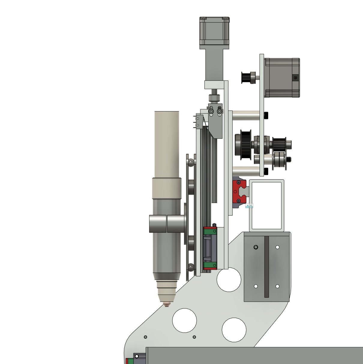

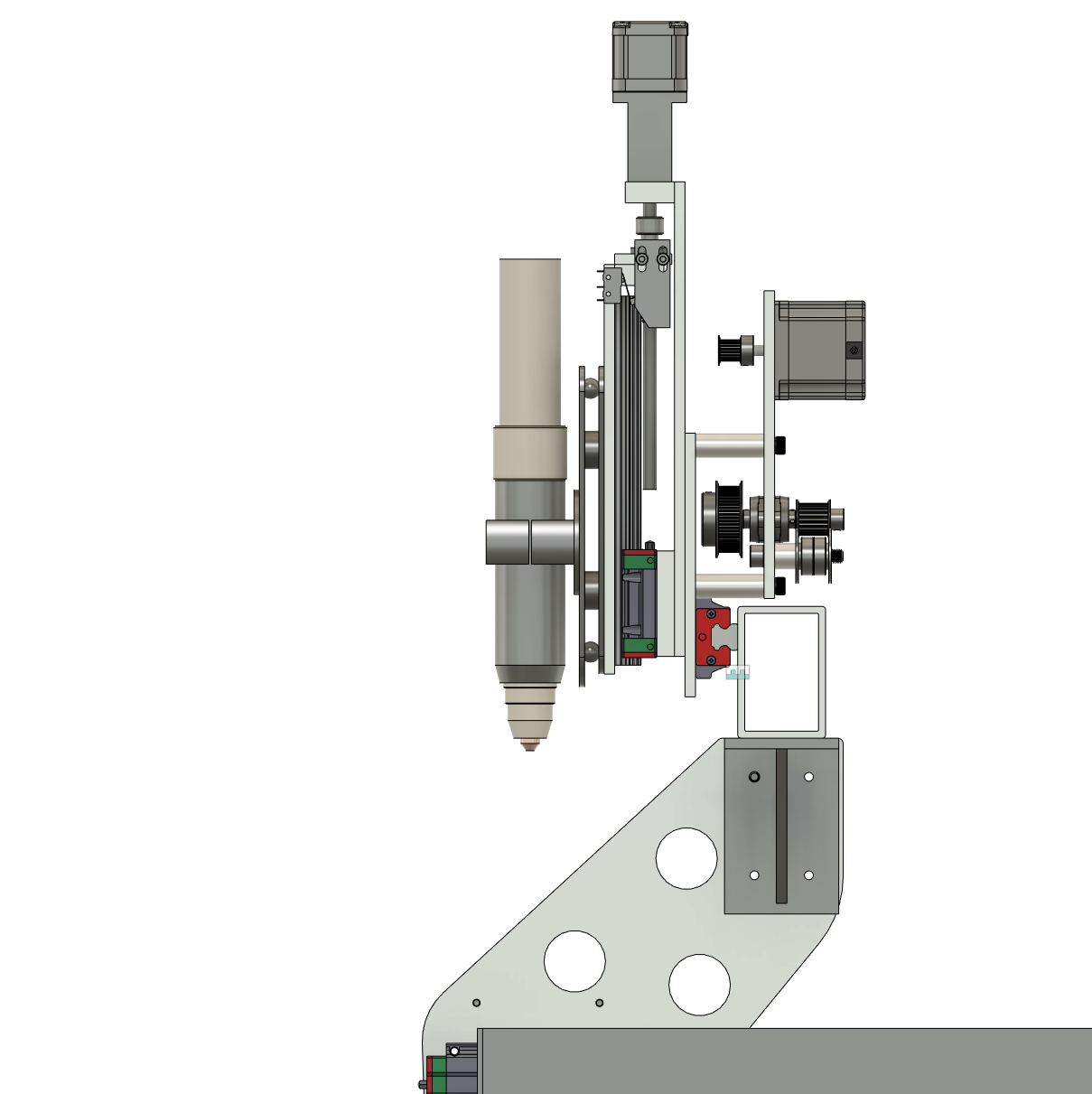

03 Oct 2021 10:03 #222087
by Joco
Replied by Joco on topic "Origami" CNC Plasma Build - folding 1200 x 600mm cut area
Been a busy CAD day as I flesh out the X and Z designs. Side views of the two mounting positions possible for standard sheet work or "tube" work up ~160mm diameter. Of course with the bracket system I could increase that in the future by creating new/taller brackets.
Standard mount.
High clearance mount
Standard mount.

One question for those following along and any who have “been there, done that”, is the single 15mm linear rail with that single truck/bearing going to handle the loads in play during motion with that assembly on it?
As a reminder the gantry supports a cutting distance of 1260mm. Overall length of the beam is 1522mm.
Should I be considering changes to support 2 trucks? Or dual rails? Or am I starting to worry about nothing?
I would appreciate thoughts from anyone more familiar with the engineering and load performance of these sorts of things.
Cheers - James.
Cheers - James.
Last edit: 03 Oct 2021 18:37 by Joco. Reason: Added gantry length data
- Posts: 12156
- Thank you received: 4149
03 Oct 2021 19:41 #222129
Replied by rodw on topic "Origami" CNC Plasma Build - folding 1200 x 600mm cut area
Well, that is not hard too determine. The HGR specs (found on their dimensional diagrams) include torque specs for Mr, Mp and My. These are 0.15 or 0.17 kNm (150 or 170 Nm) depending on the direction of the rotation about the carriage.
Force from inertia = m x a
So say your assembly weighs 5 kg and your acceleration is 3 m/sec/sec, your inertial force equals 15 N
If you were to use CAD to define the centre of gravity of your assembly, you could define the rotational torque applied. Lets say your CoG was 100mm (0.1m) from the linear rail, the torque would be 15 * 0.1 = .15 Nm, about 1% of the HGR spec.
So at a guess, you have nothing to worry about

Rod - THANK YOU! I'm a bit shite at the physic's stuff. And invariably get myself turned around and bent in half trying to work it out. Then look at the numbers and never quite trust them.
So with the independent review I will barrel on as planned. Only bunner is wont be in town until next weekend. But means I can plan out all my machining steps. Might do one last tweek to how the nema23 is mounted. It would ideally have a 6mm offset to the left so way more of the pully is fully engaged on the motor shaft. So a bolted overlapped plate will do that. Or I just try the existing design on that part and see how it goes. Can always remake/adjust it.

03 Oct 2021 21:17 #222142
HGR/HGH/HGW combo at 15mm will handle that easily but MGN15 will not be comfy.
www.hiwin.com/pdf/linear_guideways.pdf
Page 21, types and loads
Page 40 loads on all directions
