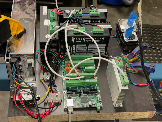

This is a bit hacky but heck if don't care, its first real world movement. Seriously ... FIRST MOVEMENT. Yeah I know, nothing new for many here but I'm stocked. It's always so cool with a bunch of design and thinking and advise taking and machining actually has a good result.
First up some photos of the setup to get things working, just to prove what I have made isn't going to be an epic fail.
Video time:

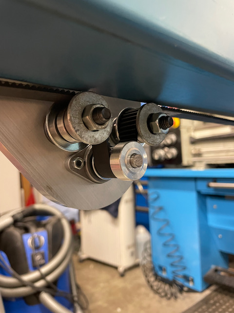

Thanks. Think I understand the guitar part. Re the "watch the straight parts of the belt" what I am taking from this is if that flat part of the belt is shift and/or the teeth on it are moving back and forth from a witness mark then you probably have excessive slack such that there is too much backlash in the system.
Re the tensioner I had a look at one of your builds again as I was trying to visualise what you are getting at. Pic below from your 2+2 thread.
Do you mean that one of the idler is in a slot and that after getting the base tension in place when clamping the ends you shift that to tune it in?
Thanks - J.
Thanks - J.
- Posts: 21980
- Thank you received: 7479
12 Sep 2021 23:57 #220380
Replied by tommylight on topic "Origami" CNC Plasma Build - folding 1200 x 600mm cut area
Yes and yes, both idlers have a small slot as the space for them is very limited.

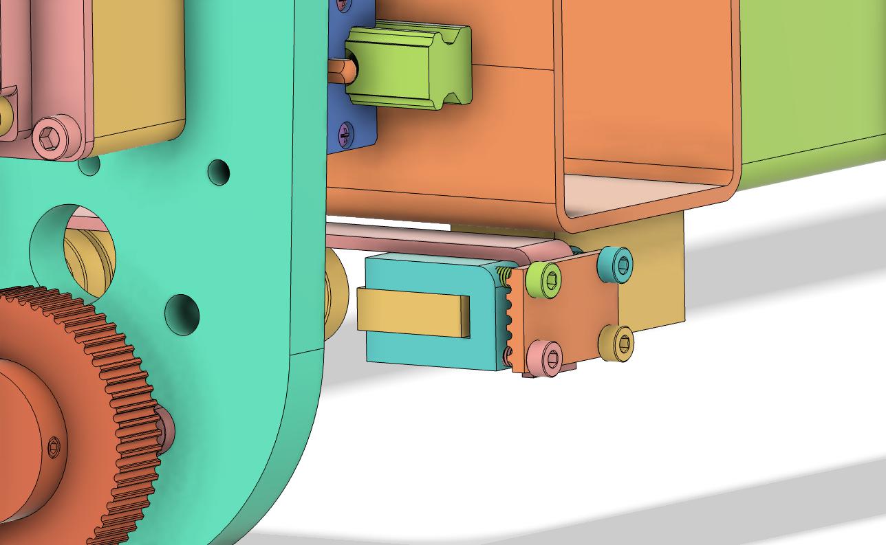

13 Sep 2021 22:31 #220520
by Joco
Replied by Joco on topic "Origami" CNC Plasma Build - folding 1200 x 600mm cut area

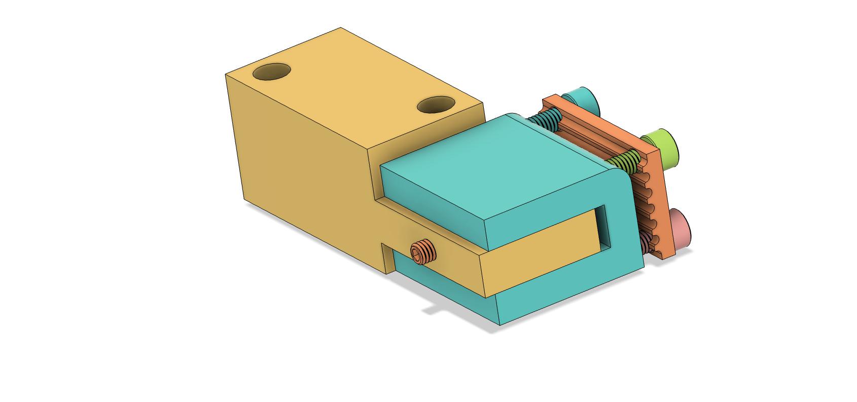

Working on belt tensioner system. I looked into following tommyligts pattern and while possibly doable its going to be very tight and if I get it wrong it will be a little destructive on the gantry side plates. So for now I am going to try something along these lines.
Tensioner assembly drawing. This will be mounted under the end of the table frame.
Shown in context of the overall assembly at the end/edge of the table top with the gantry side shown in a homed position. I might end up using this end as a fixed mounting point and put the adjustable end (the one shown) at the other end where this is a bit more room .
Not perfect but workable I think.
