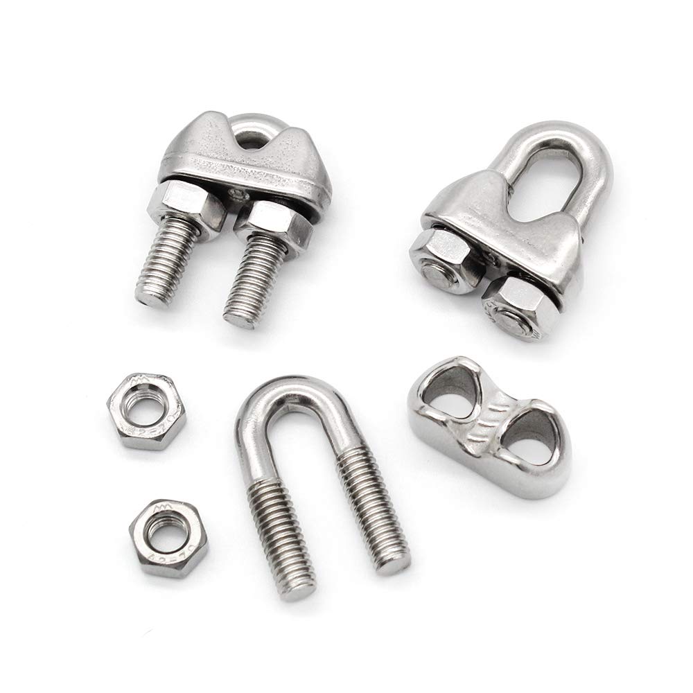

Blatantly stole that picture from the internet!
On last two builds i used two of these for each belt on the Y axis, so total of 4.
Used just the U part, ditched to bolts and got some nice shiny covered bolts instead, drilled holes on each side and voila! Now i have about 4 cm of slack and it also looks like a feature on the black painted legs.
Reminds me, i need more of those.
There are plenty of sizes to choose from.

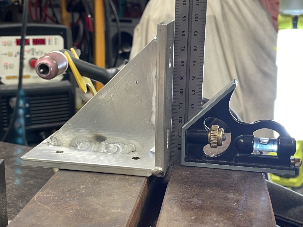

19 Sep 2021 10:01 #221074
by Joco
Replied by Joco on topic "Origami" CNC Plasma Build - folding 1200 x 600mm cut area

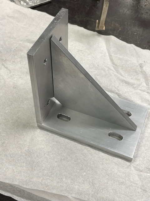

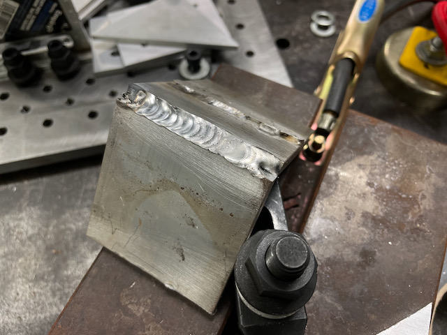

Short progress update. Major win this weekend was getting the aluminum (6061) for the next stage of the build.
1. gantry beam is RHS 75x50 with a 4mm wall.
2. 65x6 flat bar to create the Z assembly and gantry brackets from. I was after 60mm wide but they didn't have any so I got what I could get.
I started on the two brackets, This was a a little intimidating as I planned to make these a weldment and I Haven't welded ali for probably over a year. So this is as much a relearning exercise as it is creating a part for the project.
First off here is an image of the a dry fit up pf the bracket.

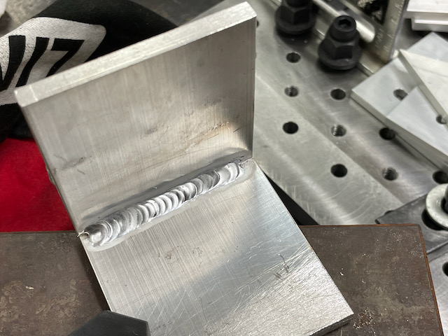

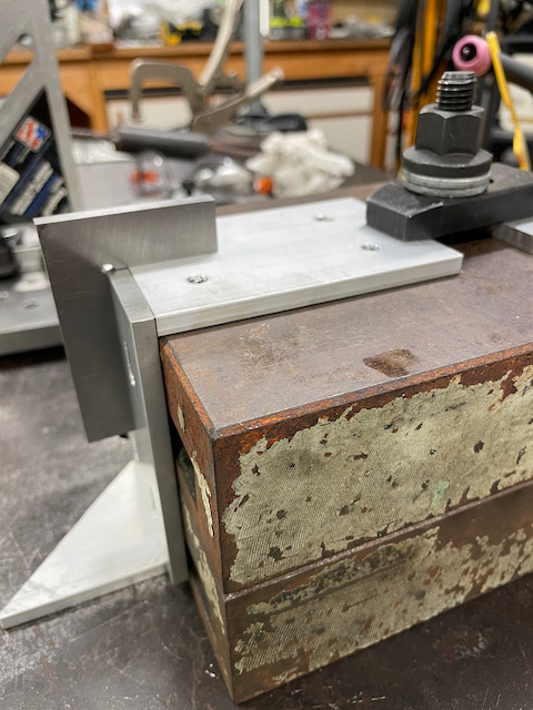

I then went on to investigate how I was going to hold this all in correct shape/alignment during welding. I needed to control potential warping. So I tried a setup and then starting thinking about the nature of the outside corner joint I had. The more I thought about it the less I liked the idea. I could do a weld down the seam but it would not have very good fusion. I could bevel one or both plates. But if doing that why not just do an edge-to-edge corner joint. That would give a space to put a lot of weld metal into.
So I trialed such a setup on some test pieces and had a crack welding it up.
Okayish. Other than when I tried to increase the strength by adding tungsten at one end.
Then had a go at welding the inside corner. Better, think this could work.
I think I will setup for this style edge-to-edge corner joint and give it a crack. Worse comes to worse I have to remake some bits.
Cheers - J.
Cheers - J.

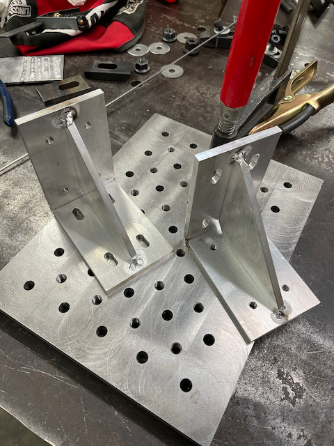

21 Sep 2021 09:16 - 21 Sep 2021 09:18 #221256
by Joco
Got one welded up tonight. Seems to be pretty square for a weldment. Will get the second one done, do a final skim in the mill on one face that has a weld and mount them up. Then on to the gantry.
The welds are functional and not pretty. Its what happens when you don't weld enough to get good practice. But they are stuck and for the forces they will be dealing with should do the job just fine.
