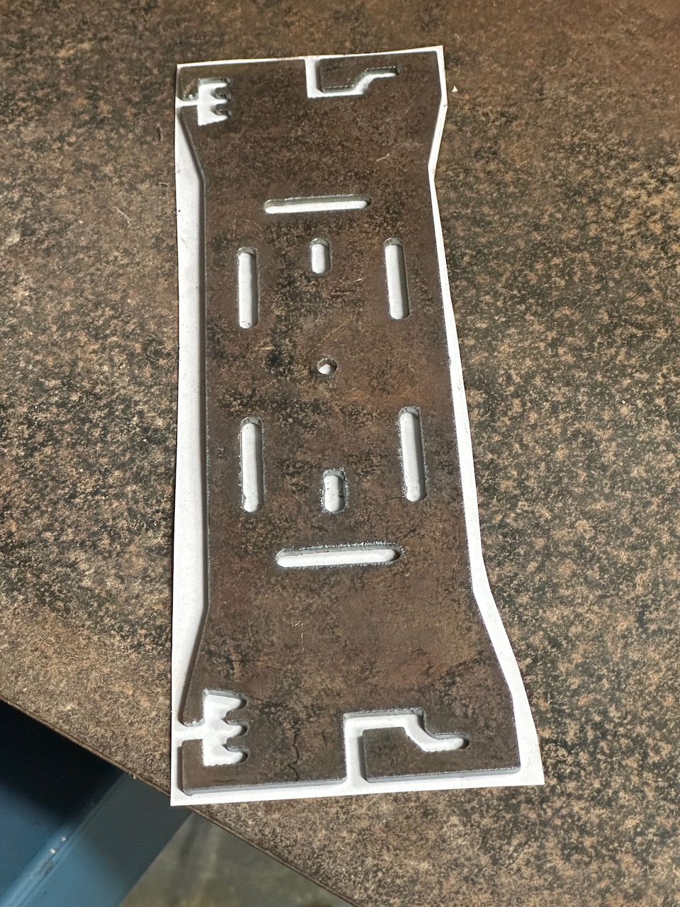

After a lot of trials and testing here is the first "complex" part cut. Still in 2mm mild stee, which is perfect for mount to be folded for my TYT MD-9600 radio.
And here is the video of the cutting process. Key details are:
Feed: 1700mm/min.
Amps: 40
Cut height: 1.5mm
Pierce height: 3.5mm
Material: 2mm mild steel sheet
Lead in: 4mm perpendeicular
Overcut: 1mm
Not saying these are optimal (e.g. overcut might be better to be -2mm with a perpendicular lead out)
Cheers - James.

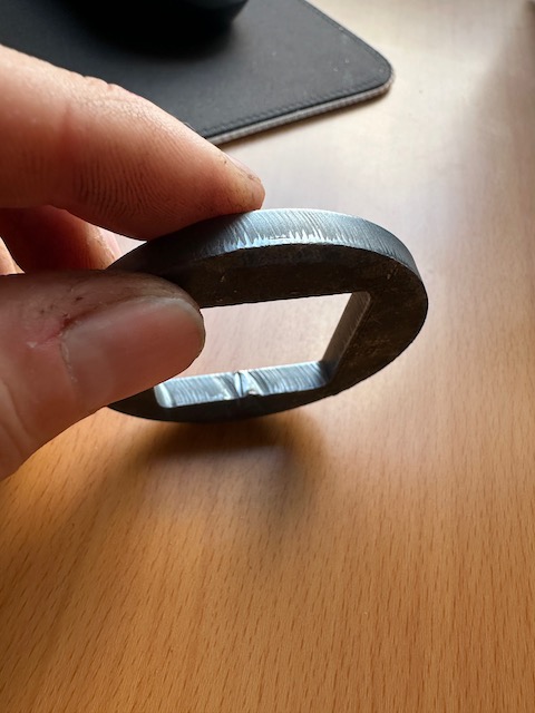

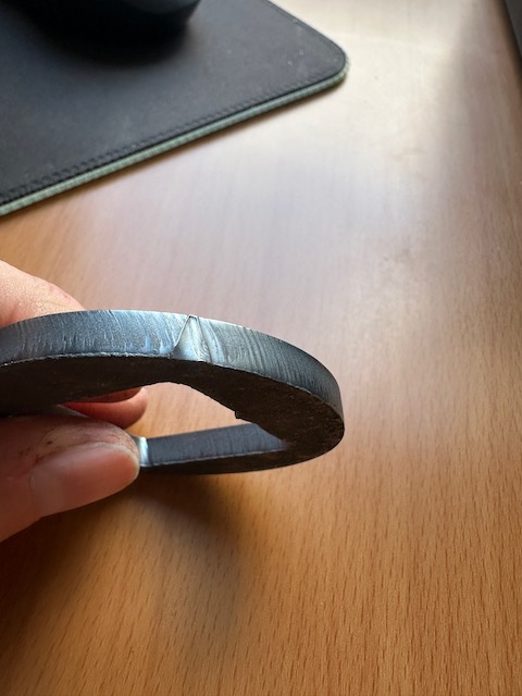

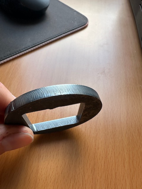

Manged to dig out some 6mm steel and try a test. Used the settings straigt out of a cut chart I found.
1200mm/min, 1.5mm cut height, 3.5mm pierce height, 45A, 4mm lead in and 1m overcut. Not a bad effort for a firsyt test cut on that thickness. But MAN the smoke! I'm going to pack things away a bit and get on to sorting the water table. The smoke/fumes are cracy.

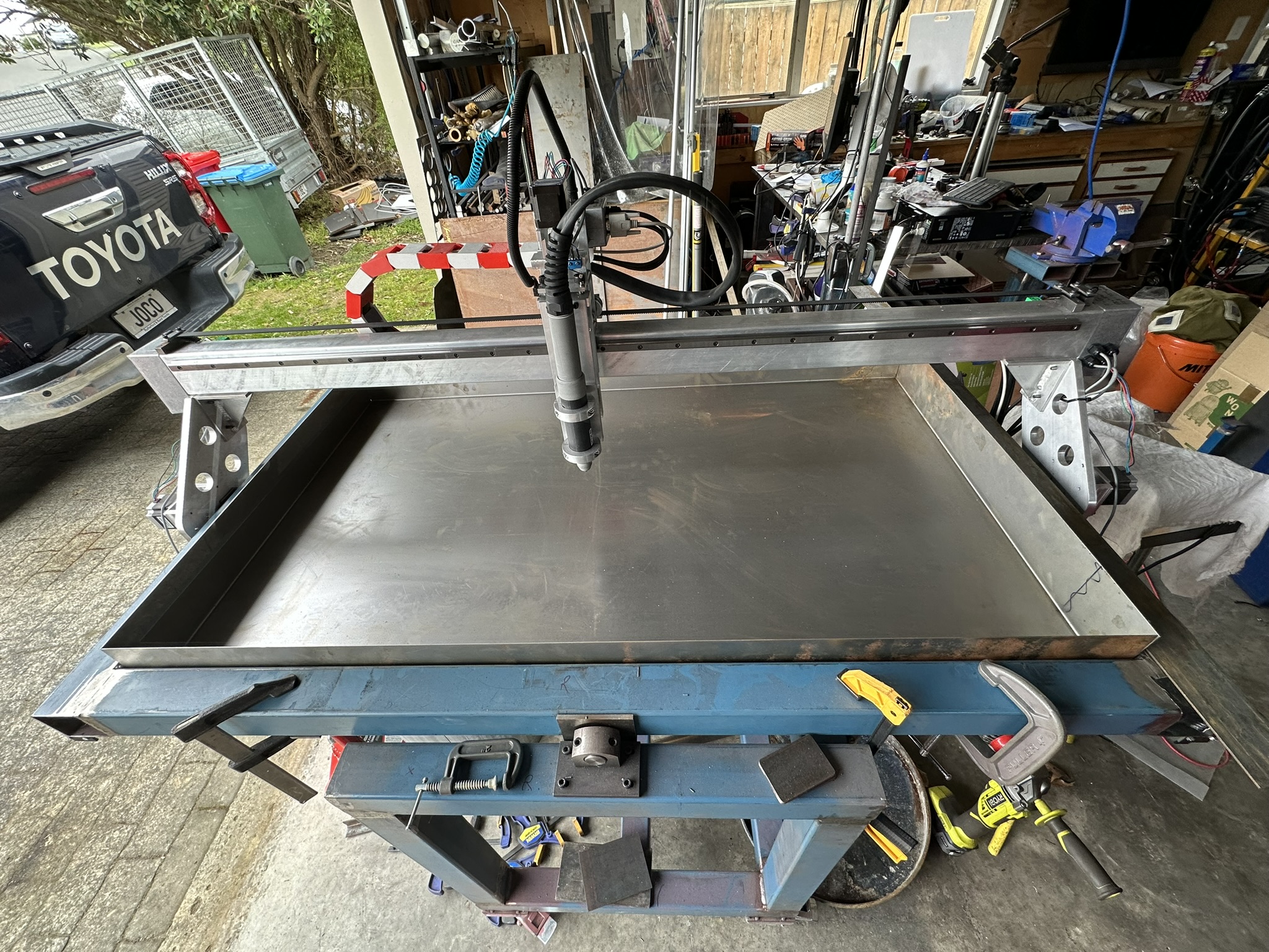

08 Oct 2023 04:15 - 08 Oct 2023 04:20 #282527
by Joco
Replied by Joco on topic "Origami" CNC Plasma Build - folding 1200 x 600mm cut area
Its 4" (103mm) deep. I planned it so I could put in a smaller (less high) set of slats for cutting under a little water. From what I could gather the under water method is most benifical for stainless. And then it will likely be no more than 3 or 4mm thick.
Today mess making video brought to you by plasma cutting without a water table. It's cutting out a shape to be folded into a sump insert for the water tray.

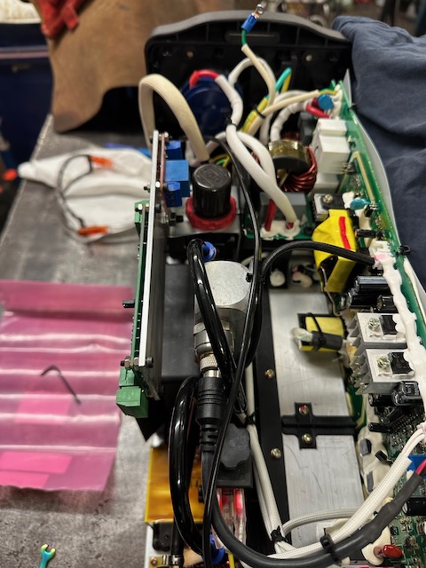

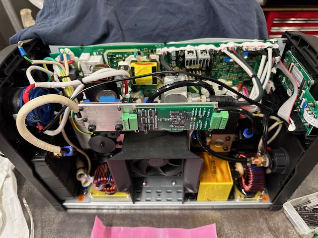

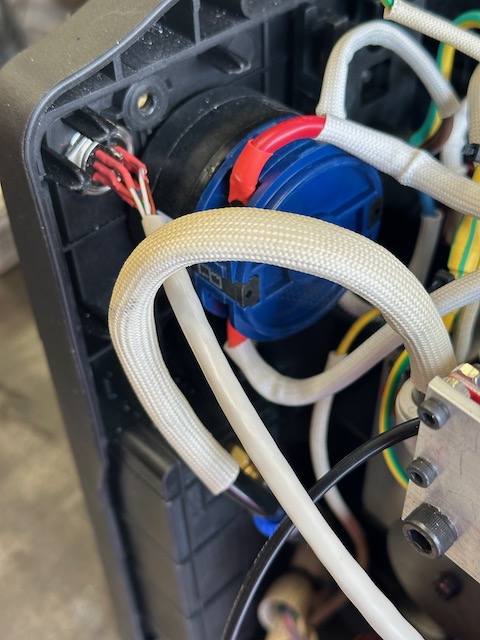

Have started the process of properly enabling the CIgweld Cutskill 60 for CNC control. Stage one is a mounting bracket that holds the THCAD and the relay for torch on/off control. Note that ArcOK is handled via a reed switch on the work return lead. This has proven to be operating very reliably.
Pic 1 shows the front view the THCAD-10 front and centre. The mounting is off the aire pressure control.
Pic 2 is looking down the length of the bracket. You can see the blue relay on the back side of the bracket.
Thanks - J.
Thanks - J.

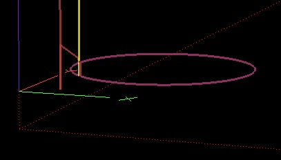

After reading the Hypertherm paper on moving pierce (ramp pierce) I have a little progress. I tried using
sheetcam generated code but it relies on having z gcode kept by qtplasmac. This also got messy as you need to touch Z0 off as material top. I decided I wanted to keep the “throw material on, align/zero xy home and go. So that meant doing all the Z ramp heigh change inside plasmac.
After quite a bit of code reading and scribbles I have an initial ramping pierce using the height stage transitions per hypertherm. Next will be the speeds and associated transition time points for them. That being Gouge, Intermediate/Crawl and Cut.
here is a sim pic of the ramp from pierce height to pierce end height then to cut height.
cheers - J
