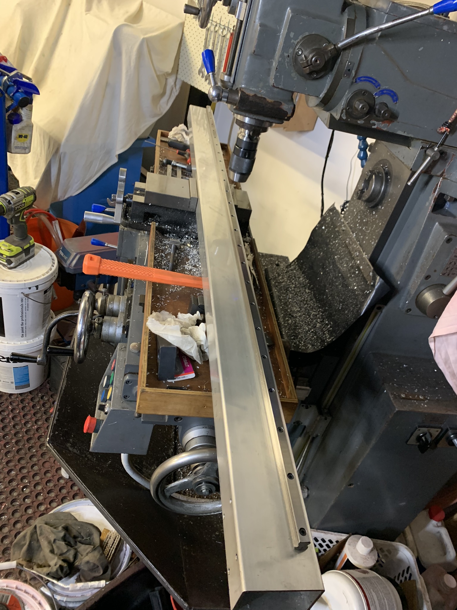

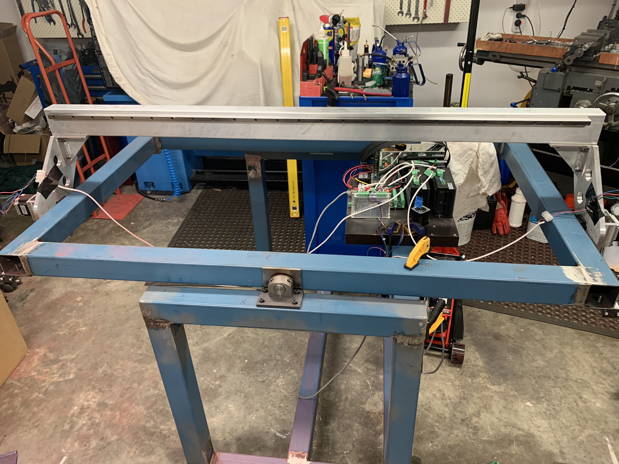

18 Feb 2023 19:12 #264768
by Joco
Replied by Joco on topic "Origami" CNC Plasma Build - folding 1200 x 600mm cut area
Back into build mode after a long break. Was up to 1am with work so filled in some waiting time getting the gantry beam sorted.
Having a decent sized mill help with accurate hole drilling. Of course a drill press would have probably achieved similar. I have seen people do all the holes with centre punch and hand power drill. I just do not seem to be able to get good results that way.
Mounted and ready to think about the carriage and drive belt.

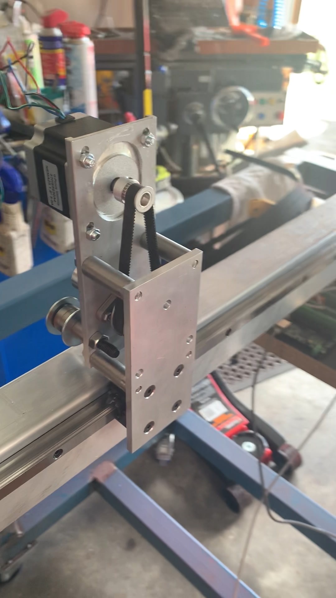

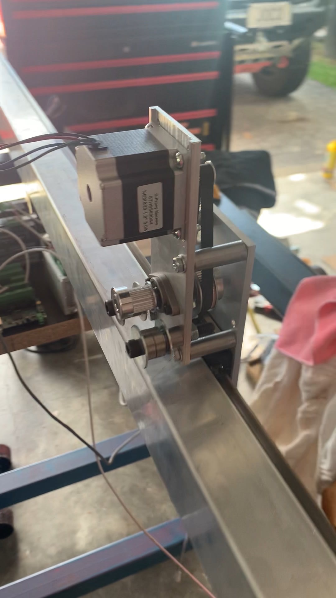

20 Feb 2023 21:22 #264904
by Joco
The following user(s) said Thank You: tommylight, rodw, RNJFAB
- Posts: 21813
- Thank you received: 7449
21 Feb 2023 00:01 #264921
Replied by tommylight on topic "Origami" CNC Plasma Build - folding 1200 x 600mm cut area
Hmmm... i wonder, where did i see that type of reduction...
Very nice, thank you.
- Joco
- Posts: 532
- Thank you received: 327
23 Feb 2023 17:52 #265129
by Joco
i read many of Tommy’s threads, advice articles and asked some questions. Nothing new in these reduction systems. Following the well documented and proven path curtesy of Tommy. Cheers.Hmmm... i wonder, where did i see that type of reduction...
