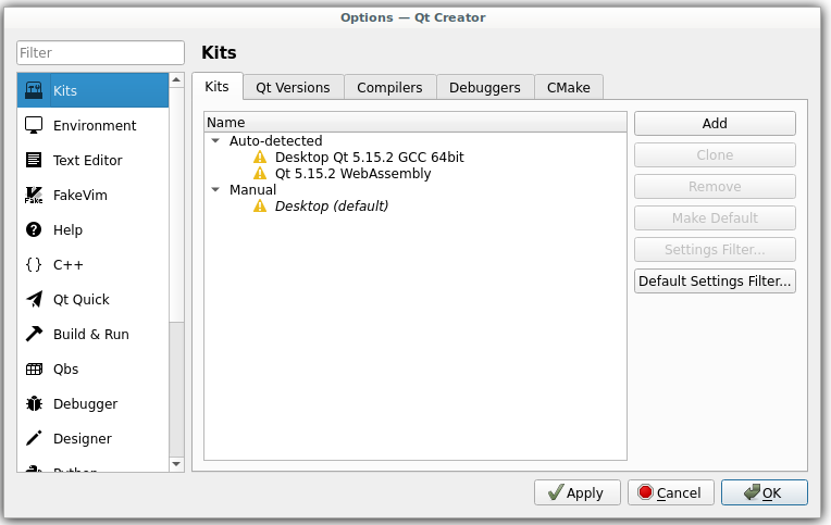

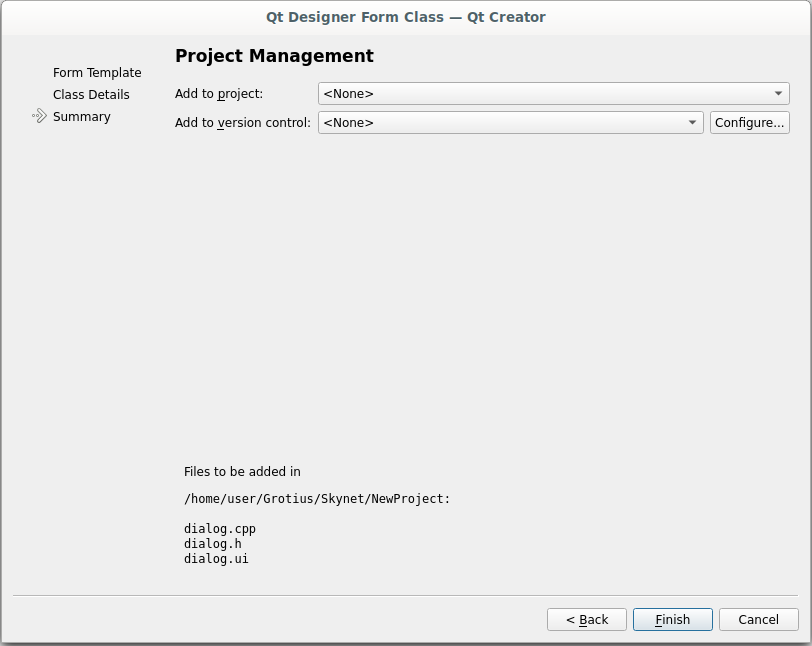

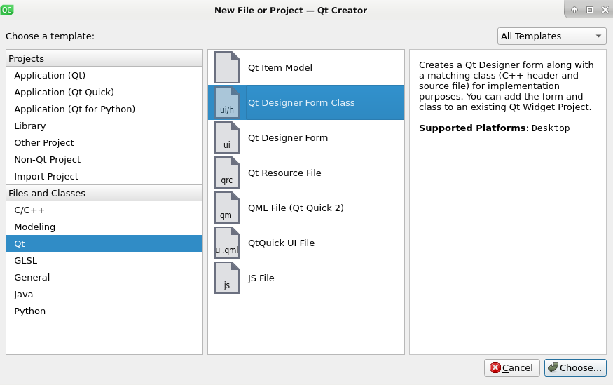

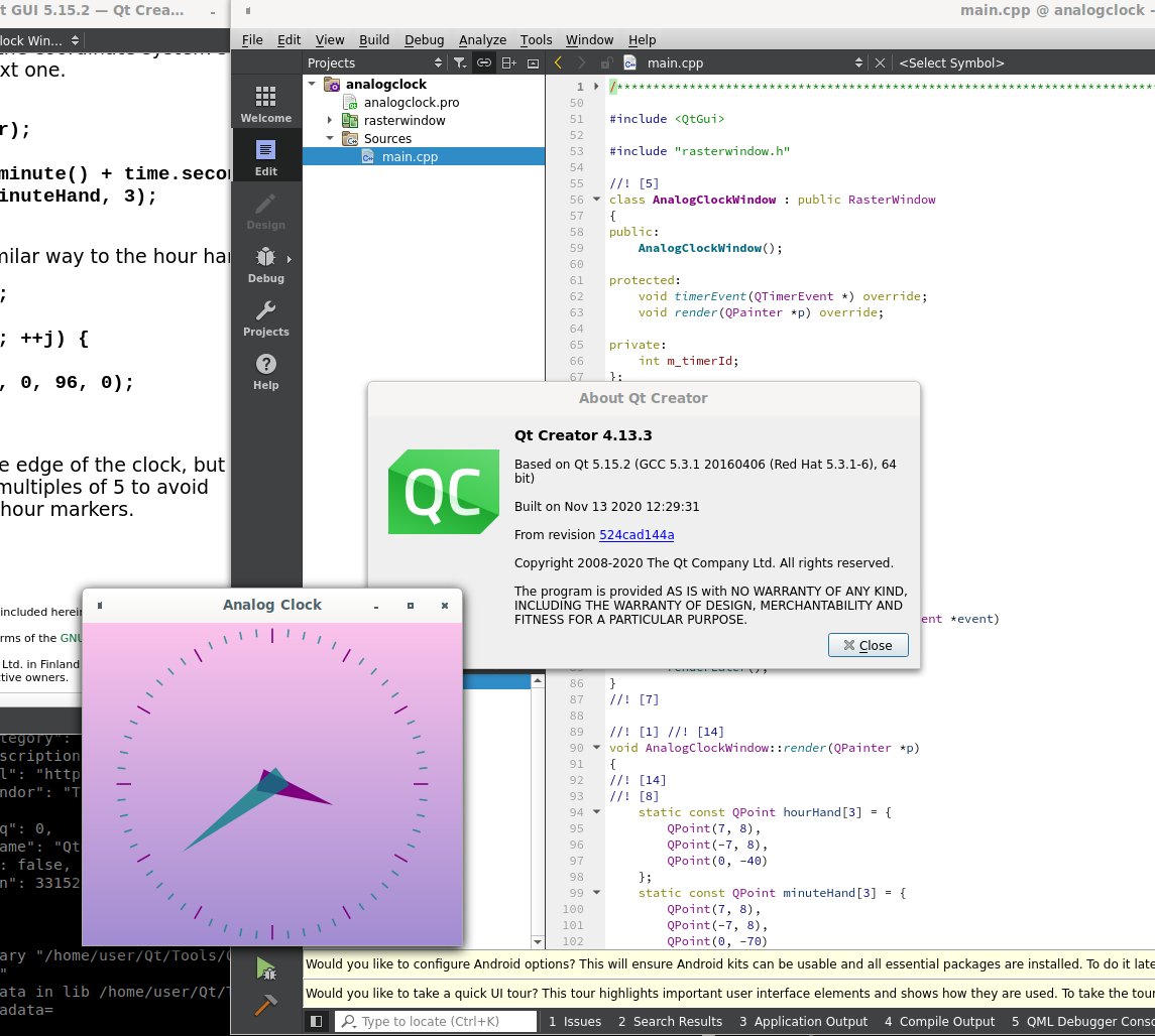

Hi Arciera,
I think it's the compiler. extra info
Your message say's the file is missing. If you follow the link, is the file missing?
$ sudo apt install build-essential
(build essentials are normally also installed with a lcnc rip, to get the ability to compile from source).
And then check this :
Important is, first start a new project (mainwindow project, no clock example) and try to compile this. If this is oke. Then open the Skynet app.

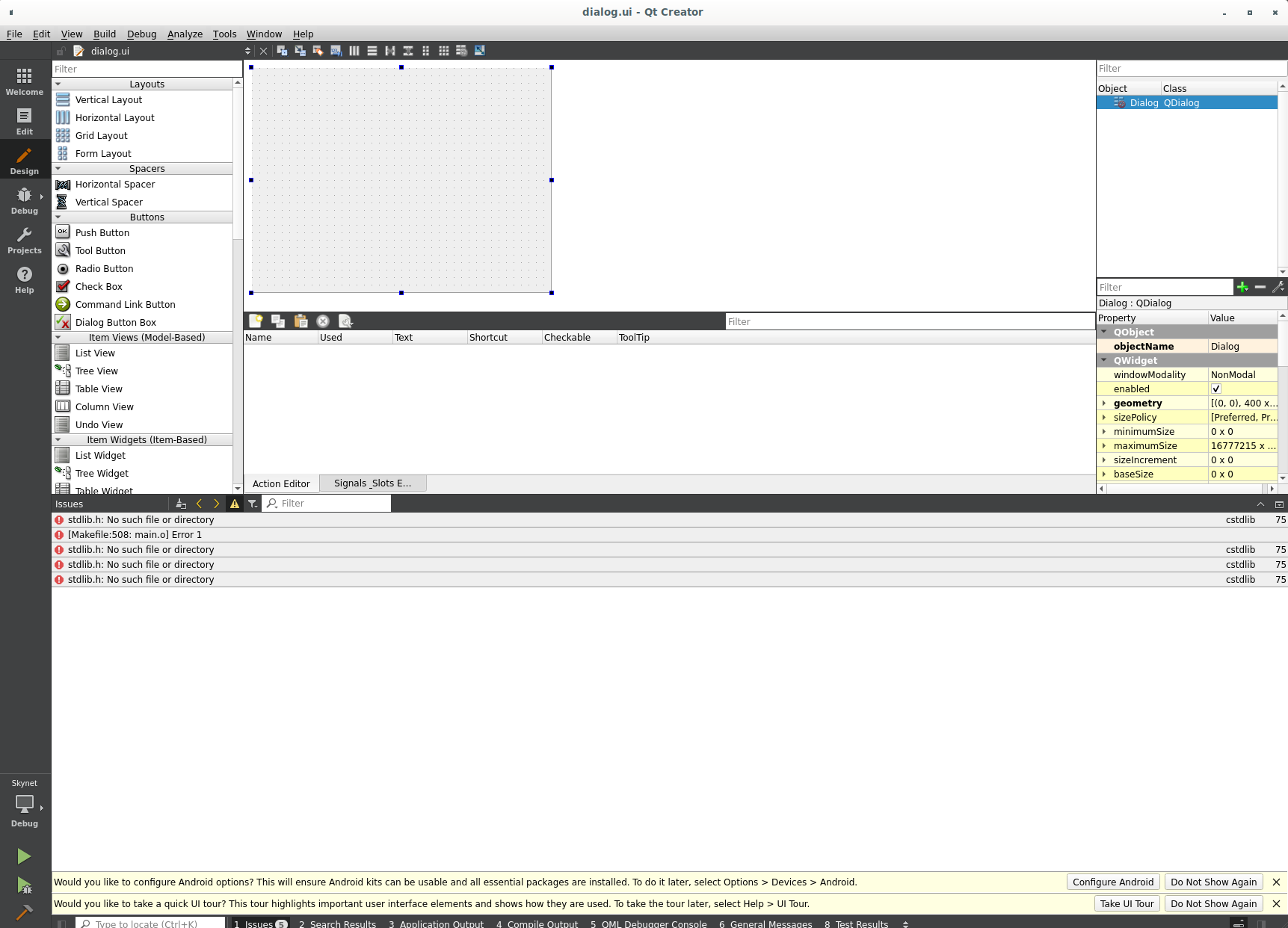

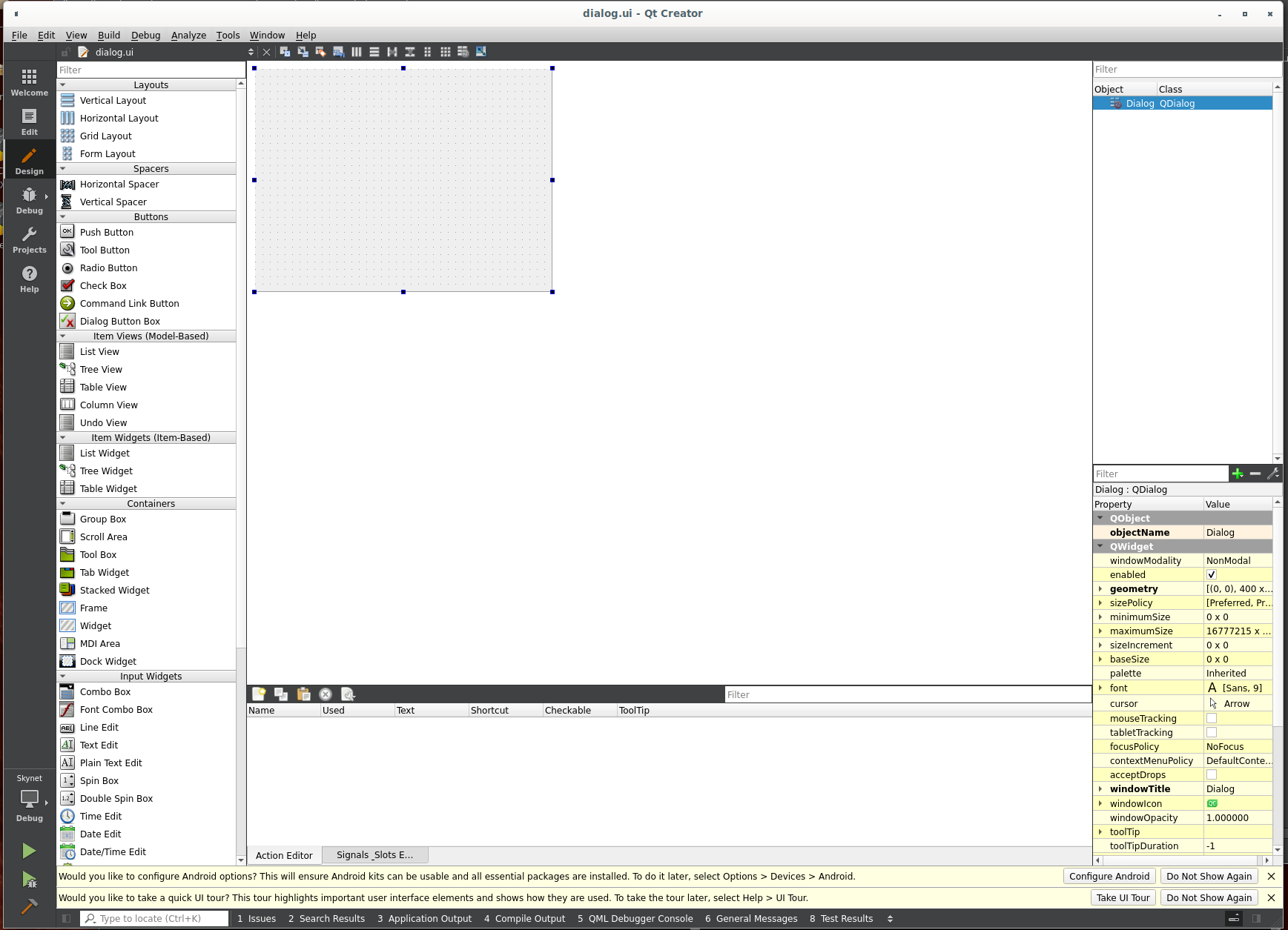

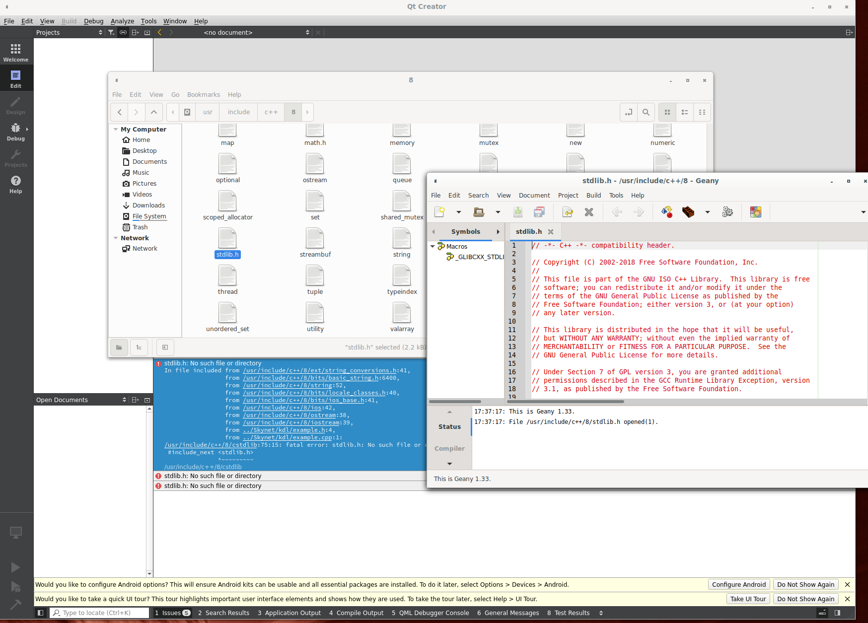

I have this:
There are lots of Hits on the net about this and most say something along the line "I solved it by removing INCLUDEPATH += /usr/include from .pro file". But sadly I'm out of my depth here.
eu.startpage.com/do/dsearch?query=qt+cre...ch+file+or+directory
Replied by Aciera on topic How would you design a real time application for cnc control in c / c++ ???
No, it's actually there:Your message say's the file is missing. If you follow the link, is the file missing?
user@linuxcnc:~$ sudo apt install build-essential
[sudo] password for user:
Reading package lists... Done
Building dependency tree
Reading state information... Done
build-essential is already the newest version (12.6).
0 upgraded, 0 newly installed, 0 to remove and 3 not upgraded.I have this:
Last edit: 27 Nov 2020 10:59 by Aciera. Reason: Corrected last Screenshot to show compile errors

Maybe try : $ sudo apt-get install g++
If you don't succeed, no problem. Then will make a stepwise install guide for you !

No, that's not it either.
user@linuxcnc:~$ sudo apt-get install g++
g++ is already the newest version (4:8.3.0-1).
g++ set to manually installed.

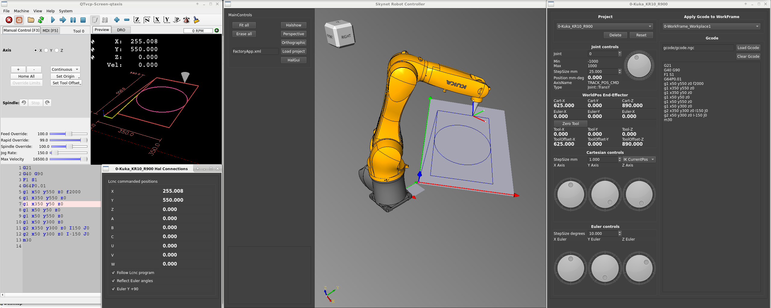

A little update.
Now the gcode is applied to the selected workframe. Multiple workframe's are allowed. Every workframe may contain a different gcode.
The program is now reflecting the (robot tool angles) euler angles to the active workframe.
In the attached video you can see that during the program, the robot can still be moved on the track, and the robot tool angles can be changed.
The video is a little bit fragmented because of the screencast recording + lcnc + skynet app together.
video
Looks good very impressive.
Seems like there were a few times when the kinematic crossed a singular point though (when the arm suddenly changes postures).
The other thing that is still not clear to me is the capability to change between Joint, cartesian world and cartestian tool coordinate mode in the same gcode.
If we only use cartesian modes the arm cannot reach all of its potential work space because the kinematic model will produce infinite solutions when the arm approaches certain postures (ie two joints becoming colinear). To move between such "subspaces" requires the use of joint mode where the inverse kinematic is not used and then we need to be able to switch back to coordinated moves where the kinematic calculates the joints position through the inverse kinematic. What would a gcode program look like if I wanted to use all those different modes and change from one to the other?

Hi Arciera,
For Qt you can download this :
qt_creator_without_bug
I tried it on a fresh grotius iso and it seems to work. I had to install cmake first.
Installing Qt from the online installer is indeed a nightmare at the moment. I hope they solve this soon.
My iso failed because Lcnc pgp key's where not found. I will exclude Lcnc from my iso and try to install it trough script just
like ethercat.
@ update :
I had the same error as you had => stdlib not found. Howto get rid of this message is at the github pre-release page.
My conclusion so far is. From a fresh grotius iso you can run and compile a new project.
If you load the Skynet app, you get the error stdlib not found. Then you have to do a workaround.
like ethercat.
@ update :
