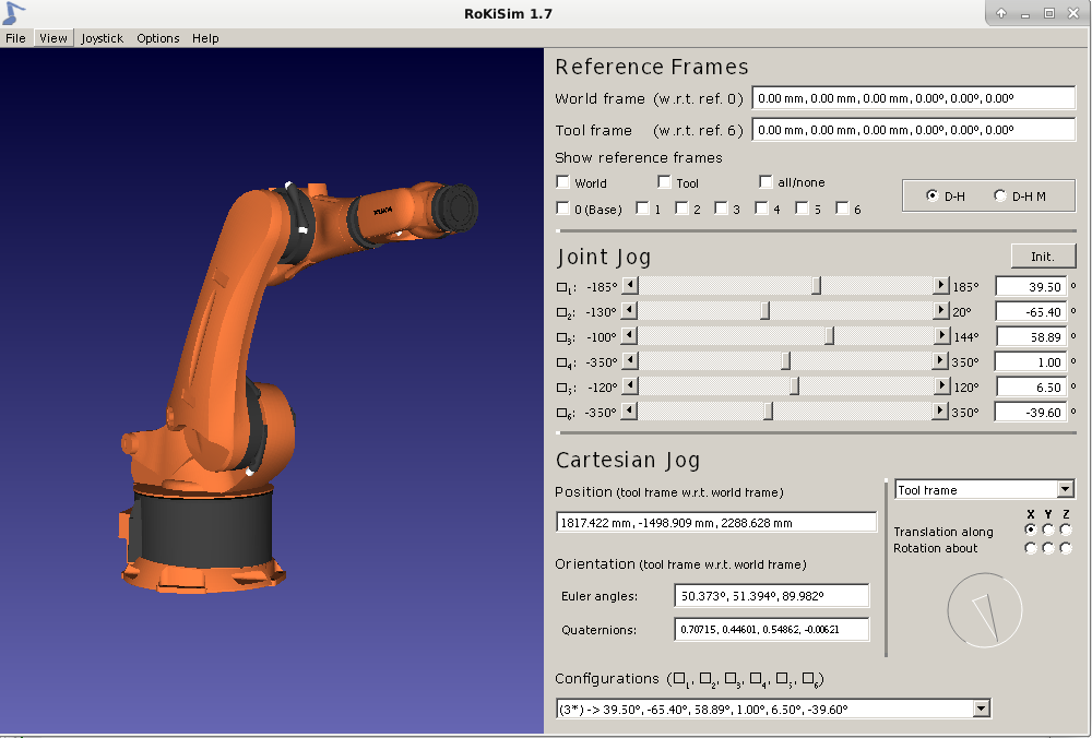

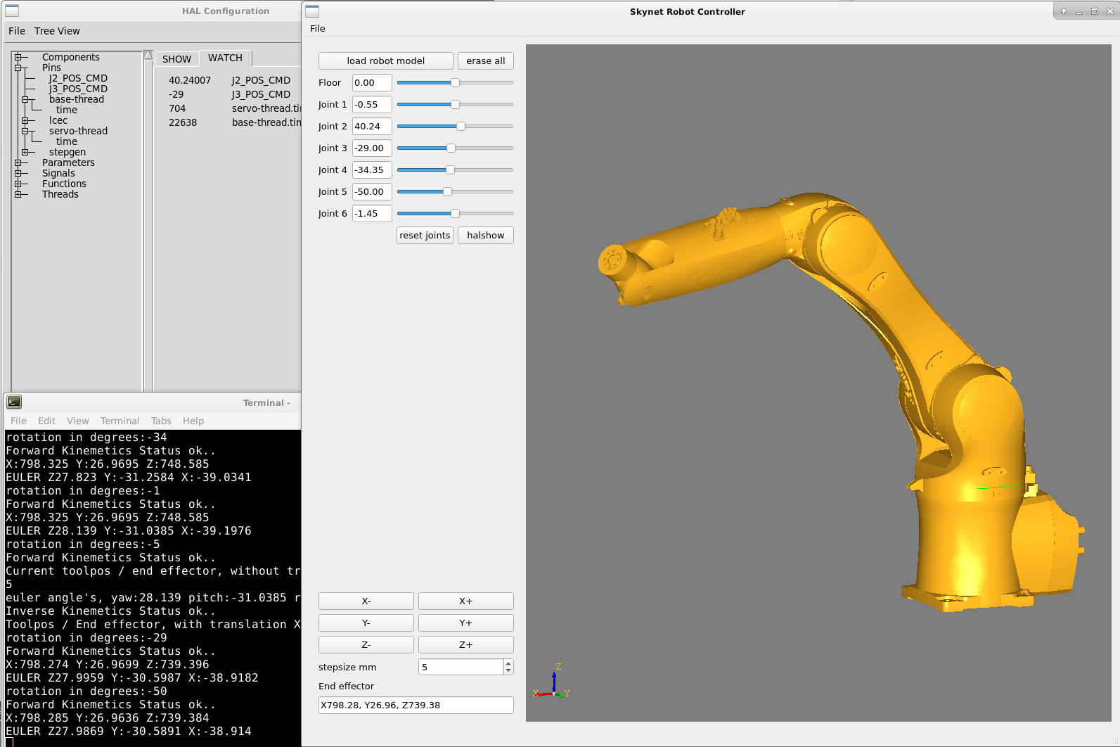

Just a little update. Trying to get things working. WIth a little succes today after studying the linuxcnc robot part.
I studied the linuxcnc puma robot source code and some articles that are made for linuxcnc in the past.
After some trial and error i was able to set up forward interpolation and a inverse interpolation c++ code for a kuka 500 robot config.
I checked the xyz output's from the inverse interpolation and this seem's oke. I checked the outputs with RoKiSim, a free robot viewer.
For the kinematics i used the KDL c++ library. Building op the robot configuration was hard to understand. I did not use the
dh parameter methode. KDL has more robot function's available, quite interesting stuff.
A preview of a working forward kinematics code :
A preview of a inverse kinematics code :

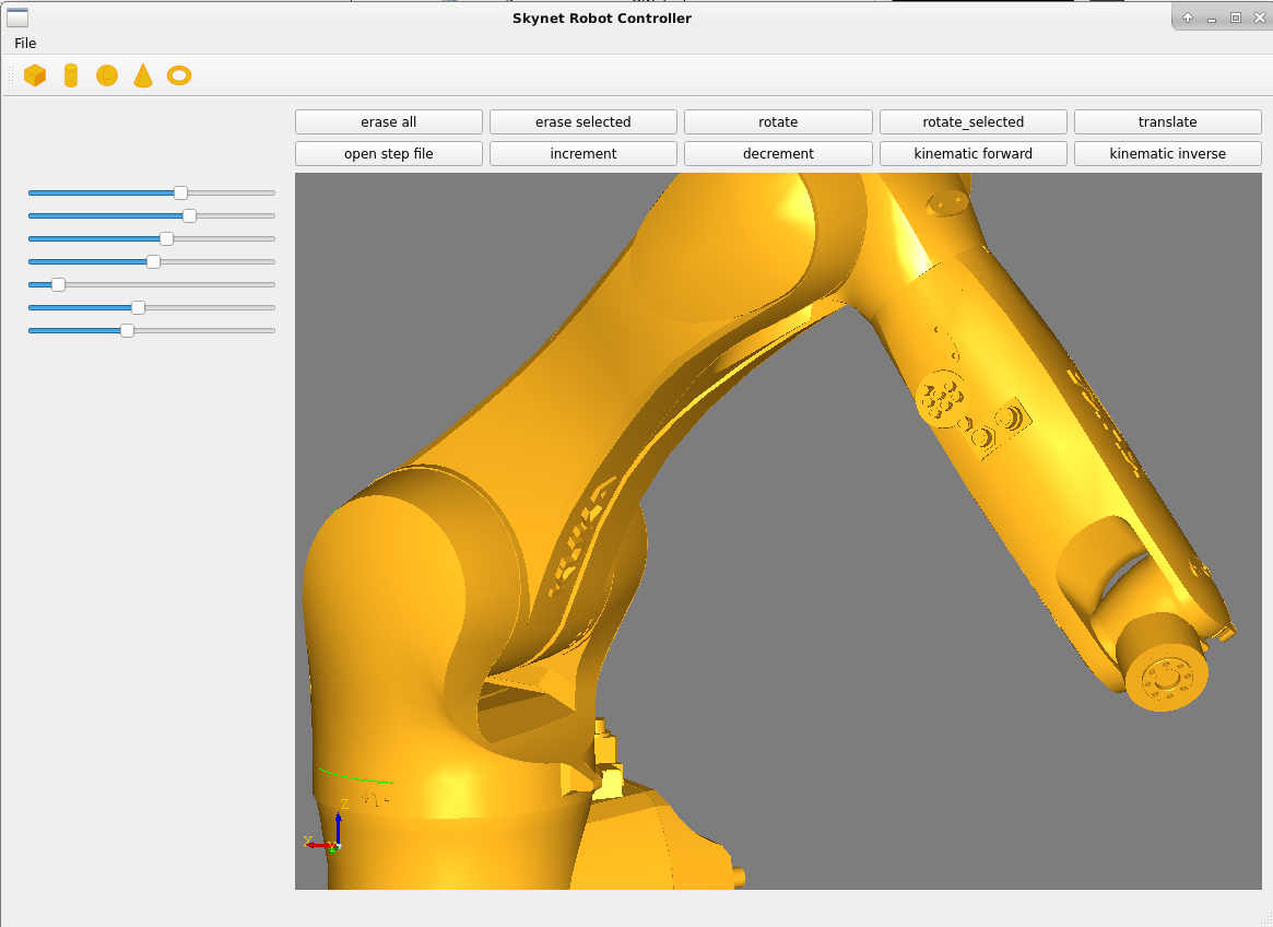

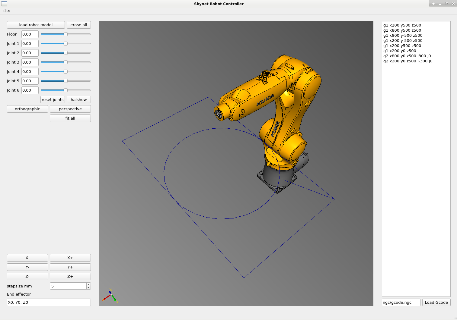

Now i am planning to integrate the visualisation of the robot stl files into the program.
The Etercat hal problem is solved. So the program can do a good job if the gui interface is ready to go.
Have a nice day !

bool kinematics_status;
kinematics_status = fksolver.JntToCart(jointpositions,cartpos);
if(kinematics_status>=0){
//std::cout << cartpos <<std::endl;
//std::cout << "Toolpos / End effector, X:"<<cartpos.p.x() << " Y:" << cartpos.p.y() << " Z:"<< cartpos.p.z() << std::endl;
cartpos.M.GetEulerZYX(yaw,pitch,roll);
cartpos.M.GetEulerZYX(alpha,beta,gamma);
//std::cout << "euler angle's, yaw:"<<alpha *(180.0/M_PI) << " pitch:"<<beta *(180.0/M_PI)<<" roll:"<<gamma *(180.0/M_PI)<<std::endl;
cartpos.M.GetEulerZYZ(alpha,beta,gamma);
//std::cout << "EULER Z"<<alpha*(180.0/M_PI) << " Y:"<<beta*(180.0/M_PI)<<" Z:"<<gamma*(180.0/M_PI)<<std::endl;
inverse kinematics secion
//Creation of joint arrays q:
KDL::JntArray q(chain.getNrOfJoints());
KDL::JntArray q_init(chain.getNrOfJoints());
KDL::JntArray q_min(chain.getNrOfJoints());
KDL::JntArray q_max(chain.getNrOfJoints());
KDL::SetToZero(q_init); //initialize with zero positions
//define q_init:
q_init(0) = ((0)*M_PI/180.0)*-1;
q_init(1) = (-90)*M_PI/180.0;
q_init(2) = (90)*M_PI/180.0;
q_init(3) = (0)*M_PI/180.0;
q_init(4) = (0)*M_PI/180.0;
q_init(5) = (0)*M_PI/180.0;
nj = chain.getNrOfJoints();
//define minimum and maximum joint positions, measure this values exactly!
q_min(0) = -185.0*(M_PI/180);
q_max(0) = 185*(M_PI/180);
q_min(1) = -130.0*(M_PI/180);
q_max(1) = 20*(M_PI/180);
q_min(2) = -100.0*(M_PI/180);
q_max(2) = 144.0*(M_PI/180);
q_min(3) = -350.0*(M_PI/180);
q_max(3) = 350.0*(M_PI/180);
q_min(4) = -120.0*(M_PI/180);
q_max(4) = 120.0*(M_PI/180);
q_min(5) = -350.0*(M_PI/180);
q_max(5) = 350.0*(M_PI/180);
//Creation of the solver:
//KDL::ChainFkSolverPos_recursive fksolver(chain); //Forward kinematic position solver needed for IK
KDL::ChainIkSolverVel_pinv iksolverv(chain); //Inverse velocity solver needed for IK
//KDL::ChainIkSolverPos_NR iksolver(kdlChain, fksolver, iksolverv, 100, 1e-6); //max 100 iterations, stop at accuracy 1e-6
KDL::ChainIkSolverPos_NR_JL iksolver(chain, q_min, q_max, fksolver, iksolverv, 100, 1e-6);
//make calculations:
//define target frame (rotation&translation)
//rotation is in Tait-Bryan angles/ZYX Euler
KDL::Frame F_dest(KDL::Rotation::EulerZYX(yaw,pitch,roll), KDL::Vector(cartpos.p.x()+double(ui->spinBox->value()),cartpos.p.y()+double(ui->spinBox_2->value()),cartpos.p.z()+double(ui->spinBox_3->value())));
//Solve IK problem for F_dest
int status = iksolver.CartToJnt(q_init, F_dest, q);
//copy q to pointer
if(status>=0){
for(unsigned int i=0;i<nj;i++){
std::cout<<"joint:"<<i<< " degrees:"<< q(i)* (180.0/M_PI)<< std::endl;
} else { std::cout << "error" << std::endl;}

Hi a little update.
I have learned opencascade a little bit. It is also used by freecad and mayo.
The responce time is increadible fast.
The robot is chucked up in 6 step files. Each step file is loaded in and connected to a transform matrix.
Later on i have to bring back the robot orginal stepfile colors and a nice background gradient view.
The robot forward kinematics is just working within the multiplied opencascade tranform matrixes.
So later on connect the kdl inverse kinematics code to the preview and check everything.
And then connect the ethercat bus and hal layer to get a realtime environment + robot previewer.
I am a little excited about this.

Replied by Grotius on topic How would you design a real time application for cnc control in c / c++ ???
I got it running.
The kinematics are working oke. xyz moves are interpolating nice.
The gui is connected to a ethercat setup with motors.
Everything run's is as expected.
Responce time's is very nice !
For the one's :
github.com/grotius-cnc/Skynet_Robot_Control_Rtos_Ethercat

Hi Arciera,
You can in fact use anything. It's suitable for parport, ethernet, mesa, etc.
Take a look at the source code hal file .
If you load a ini file with it, combined with some hal logic, you can execute gcode files with it trough the lcnc environment.
The program is minimal at the moment. I have to integrate mdi commands, etc. But for now it's oke.
A nice thing to know is, you can edit the robot kinematics to something whole different, like a human shape, with arm's and leg's.
The kdl lib can handle this all including mass rotation inertia calculations. Wich are not included now.
Minimal code = better to understand.

I did some work on the cad preview.
To come this far with the opencascade cad preview was quite a struggle.
It looks already better then my previous post.
The latest release can be downloaded here.

After struggling for 2 day's with importing no colors or wrong colors from stepfile's, I finally succeed to do this.
It was a stupid mistake i made.
Just integraded a gcode previewer (parser) This is just a function test for lines and arc's.
It looks quite promising to replace the linuxcnc gremlin gui with opencascade. Then you can see your machine moving while its
running.
The plan next week is to make a template for 3 types of machines :
1. Gantry 3 axis
2. Robots 6 axis
3. Rotary deltakins 3 axis
This includes the kinematic calculations and saving and loading machine config's as xml. Like the ethercat xml file.
A nice thing to mention is that the gcode has to be placed in a xyz coordinate frame. Then it can be moved in place and rotated
very easy.
The blue line is the gcode path.
