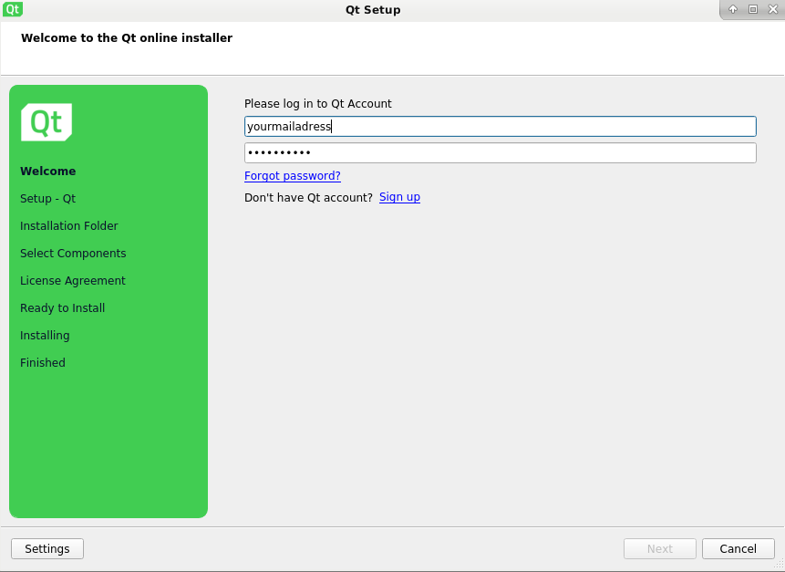

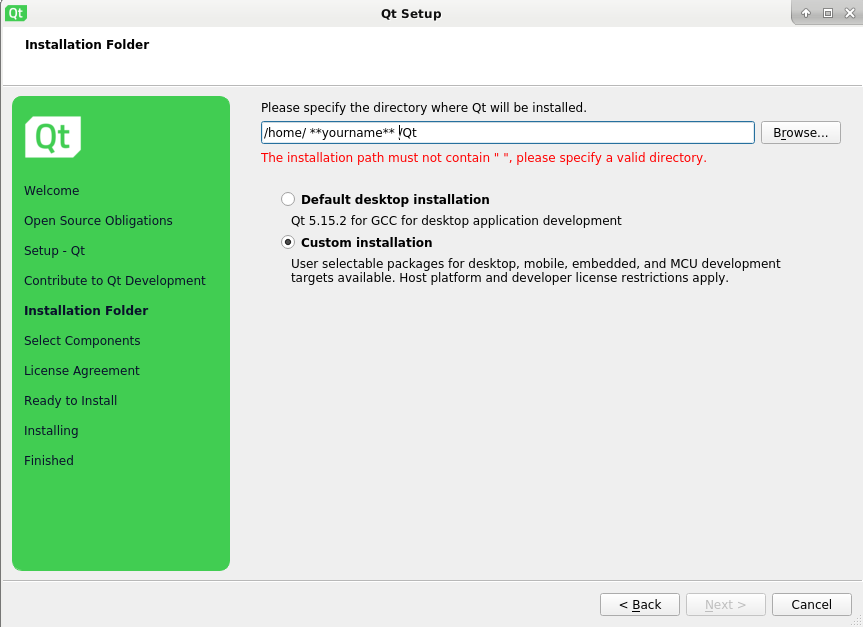

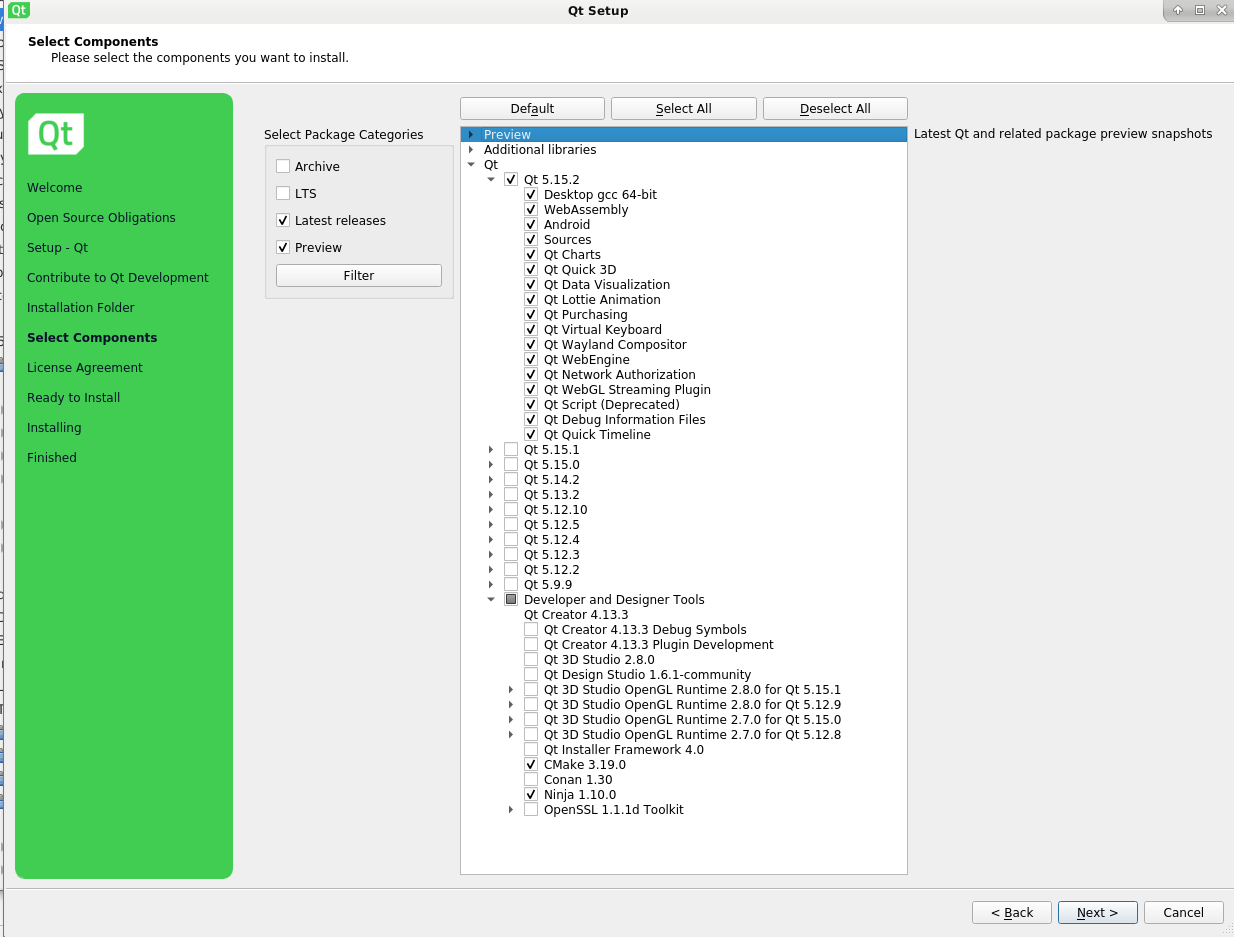

The other problem is with qt : I noticed your ISO was missing "qt creator" in the menu.
Hi, yes the qt c++ creator is not in the iso. I am looking to include this in the future.
If qt install was succesfull normally you would have the launcher icon in application menu / development / qtcreator
If not you could search the launcher in :
"/home/ **yourname** /Qt/Tools/QtCreator/bin/qtcreator"
So I made an account and ran the online installer choosing "Default desktop installation" and it seems to install fine but it doesn't launch qt creator with the box checked and there still is no menu entry "qt creator"
Oke try the above, if it's not present we have to focus on this.

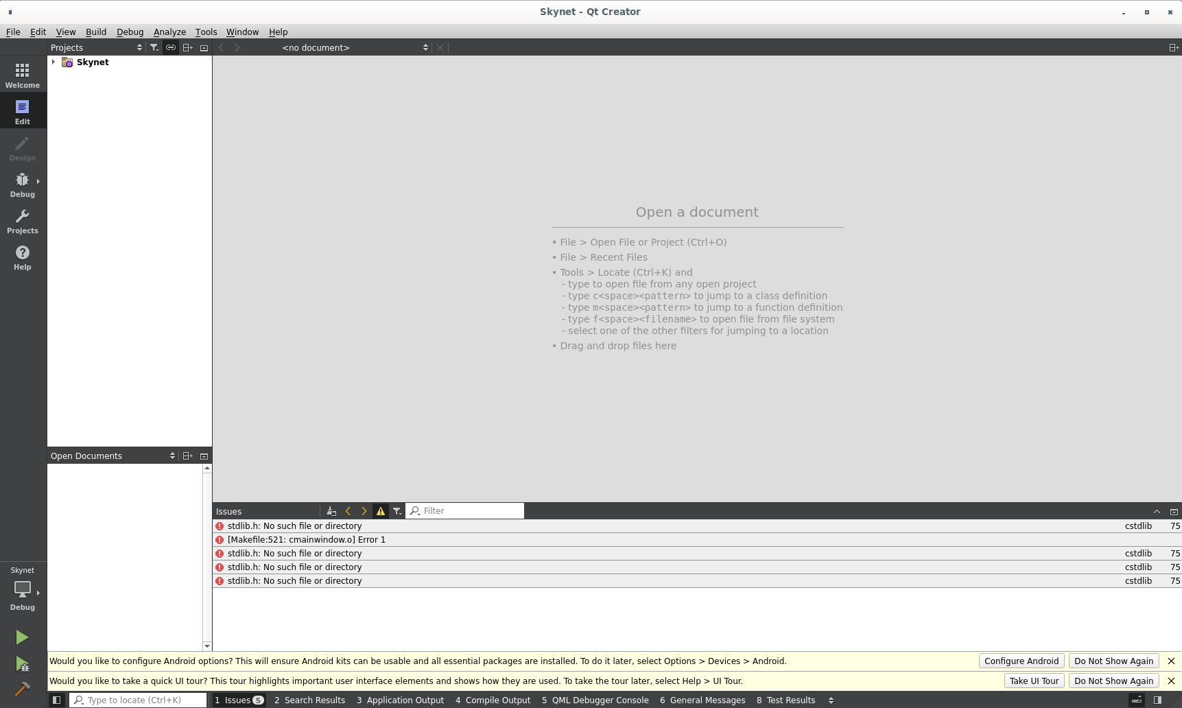

There is no icon but a script that produces the mentioned error:
So I tried: sudo apt-get install qtcreator
and now there is the launch icon and I can start Creator but if I try to compile Skynet.pro I get the error:
So I deleted the /home/Qt folder and ran the qt online installer again using the "default desktop installation".
Same outcome: no icon and running qtcreator.sh gives :

AbortedSo I tried: sudo apt-get install qtcreator
/usr/include/c++/8/cstdlib:75: error: stdlib.h: No such file or directory
#include_next <stdlib.h>
^~~~~~~~~~So I deleted the /home/Qt folder and ran the qt online installer again using the "default desktop installation".

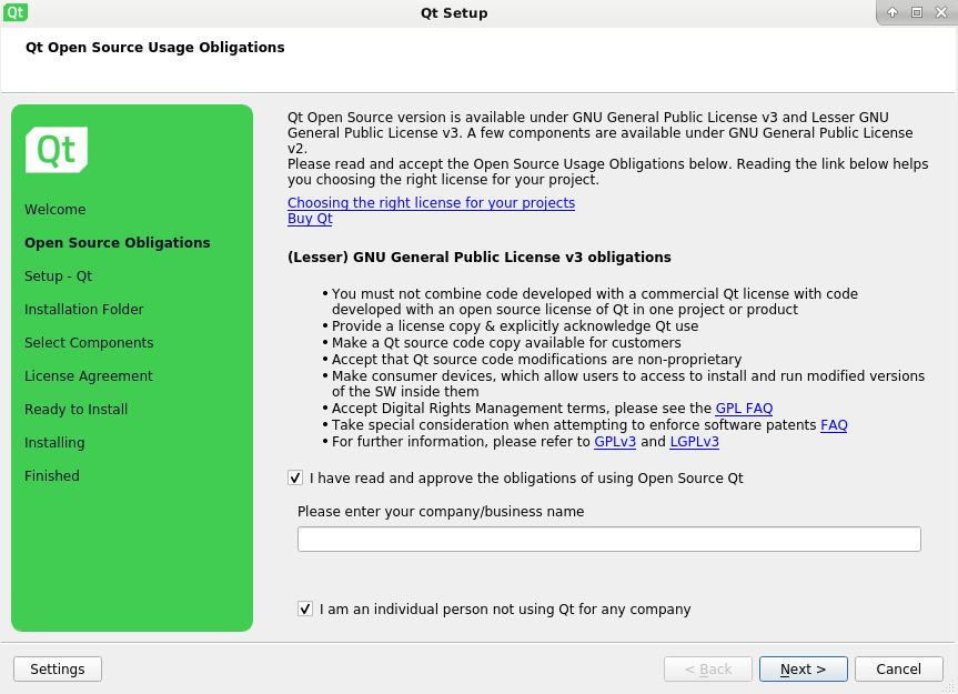

Hi Arciera,
There is a difference between qtcreator and qtcreator.
If you do a install trough command line, you get the qtcreator wich can be used for lcnc python etc.
You need the qtcreator enterprise. This is the c++ version.
This is the online installer for download.
www.qt.io/download-thank-you?hsLang=en
The filename is : /home/ **yourname** /Downloads/qt-unified-linux-x64-4.0.0-online.run
Then make it executable.
Oke this are the steps for install QT.
Let me know how it goes..

Ok, I fixed it:
Seems that libxcb-util1 is missing in the repository after adding this I can start creator:
software.opensuse.org//download.html?pro...package=libxcb-util1
Next Problem is that I still can't compile Skynet:
