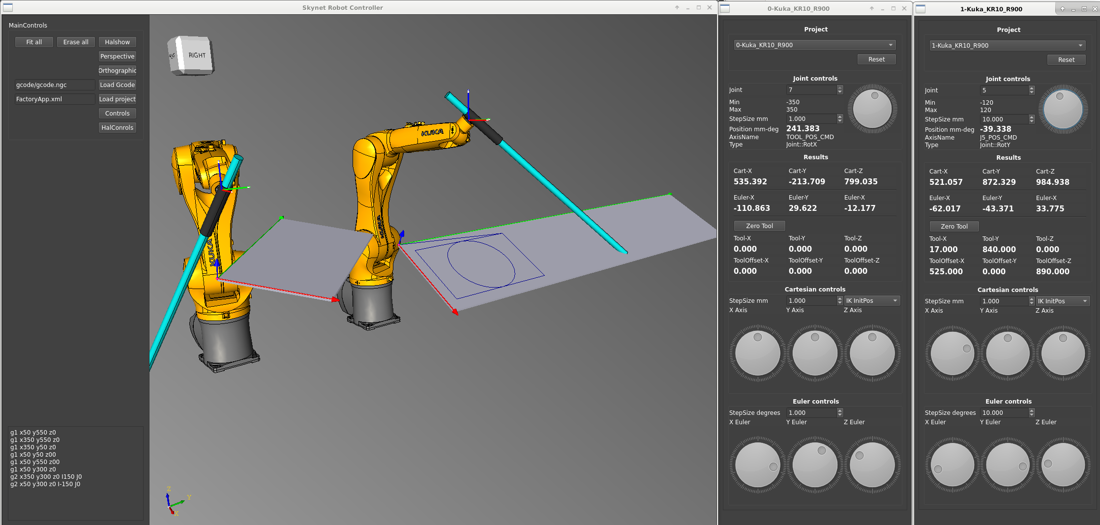

22 Nov 2020 15:13 #190081 by Grotius
Hi Arciera,
particulary how it interfaces with the gcode.
The purpose is to use the lcnc gcode infrastructure and motion handling to start with.
My program display's the ngc code as it is trough a tiny parser. But lcnc is doing the work.
If you feel like it you can have a look at the different jog operation modes
This is exactly the industry standard. I want to start the program with a minimal working example. For now that only including the
robot frame. The robot and the tools can be defined. The tool can rotate about it's centerpoint. But is not fully functional as it can
move in toolframe axis. Also workframe has to be integrated. This is all not very difficult.
to switch between the different coordinate systems and thus between different kinematics.
The kinematics are stay same for the robot.
If the gcode program uses a workframe, it will multiply the robot fk/ik by that workframe-matrix and apply some tool offsets to get there.
For now it's not available, but has to be coded.
to use the switchkins capabilities to switch from joint mode to cartesian world mode with the zero point on the bottom of the robots base and use remaps like G90.1 to specify a move in tool coordinates. How would this look in your scenario?
If you look at the last posted picture, you see already a tool offset. This is the first step to zero the gcode startpoint.
You know later on, it's like a workframe including the euler angels.
For this workframe and zero point for the gcode i will show a box with a trihedron to show what is going on. Its the same as in your pdf document.
There needs to be a jogging possibility in the different coordinate systems and the capability to save the joint and/or cartesian positions of the current posture of the arm.
Yes of course. The controls are already there. These controls are for jogging. They work very well. You don't have to switch between joint or cartesian mode. It will update each other on the spot.
The planning is to make a gui screen for each solution. This will keep the program very modulair. So every option is a widget with a gui.
A widget includes a source file and a header file and a gui (hmi window)
-Teach in
-Gcode
-Controls
-Hal connections
etc.
Now coding the automated hal connection's.

23 Nov 2020 12:21 #190132 by Grotius
I did the hal connections today and made a short video when it simulate a lcnc gcode.
Sinds there is no freedom of speech on youtube (not imporant for me, but for other users) i do it this way :
video
The following user(s) said Thank You: chimeno, tommylight, Clive S, Mud

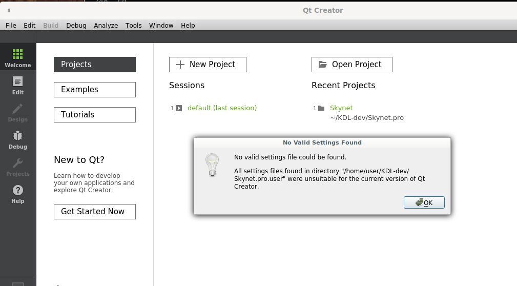

I'm curious so I'd like to have a look, but the learning curve is pretty steep. If you have the patience, could you maybe point me in the right direction with setting this up?
So I downloaded your git repo.
git clone git://github.com/grotius-cnc/Skynet_Robot_Control_Rtos_Ethercat.git KDL-dev
I installed qt:
sudo apt-get install qtcreator
sudo apt-get install qt5-doc qtbase5-examples qtbase5-doc-html
sudo apt-get install qt5-default
[edit] also needed:
sudo apt-get install qtdeclarative5-dev
I installed the OpenCascade library:
libocct-visualization-7.3
and the KDL library:
liborocos-kdl-dev
Now I try to open the Skynet project in Qt Creator but I get an error saying its missing a "valid settings file":
[edit]
Ok, I'm a step further by doing this:
Go to Tools -> Options.... Select Build & Run on left. Open Kits tab. You should have Manual -> Desktop (default) line in list. Choose it. Now select something like Qt 5.5.1 in PATH (qt5) in Qt version combobox and click Apply button. From now you should be able to create, build and run empty Qt project.

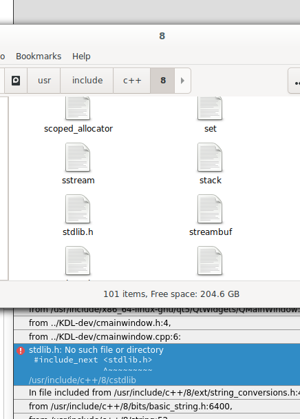

Now I get errors "stdlib.h: no such file or directory"
[edit2]
looks like I'm missing the folder /user/include/c++/8/stdlib
Last edit: 24 Nov 2020 08:46 by Aciera.

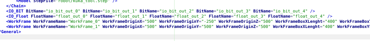

I have integrated the Tool WorkFrames into the project.
If you have a gcode file like this :
g1 x50 y550 z0
g1 x350 y550 z0
g1 x350 y50 z0
g1 x50 y50 z00
g1 x50 y550 z00
g1 x50 y300 z0
g2 x350 y300 z0 I150 J0
g2 x50 y300 z0 I-150 J0
And in your xml config file you have the Workframes defined as :
Then you select wich workframe you wanna use. And walla your gcode is applied to the WorkFrame.
Result so far.
It took quite a few hours to make the workframe basis including :
A box displaying the workframe sizes.
A green, red and blue tube + cone. (axis arrows)
A purple sphere. (origin)
Then i had to do some matrix transformating, rotation magic. And walla.
