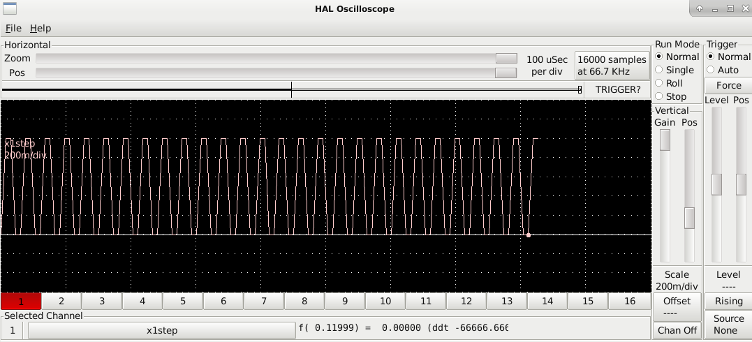

19 Oct 2020 14:01 - 19 Oct 2020 14:56 #186604 by Grotius
I have some little news.
For a while i was trying to write a real time app from scratch. The test result's where crap.
The test's where based on how to get the maximum stepper velocity output, which is a good indicator when connected to real hardware.
In the tests the step-timing was done at user level land and was resulting in a un-stable step generation. The max stepper speed was also quite slow. I stopped this development for a few weeks.
After some time i was able to release a linux rtos ethercat distro. Then i started to test real time again.
I came to a solution that makes profit of the hal environment. This was after some trial and error the best way to go.
The step generation output is at nice speeds, and stable. The test is done by a Ethercal EL2124 (5v pulse module) connected to a stepperdriver and steppermotor.
Halscope output :
Can i read the halscope as 4 pulses in 100 us?
The files that are used for this test :
- gui (hmi)
- ethercat.hal (config file to connect pin's etc quite easy)
- ethercat_config.xml (ethercat modules setup)

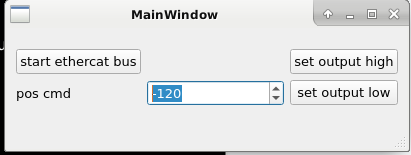

The workflow that i end up with is :
1. The gui makes some hal pins for i/o with hal and then loads the ethercat.hal file.
2. The ethercat hal file loads the ethercat_config.xml file
3. The ethercat.hal file has a stepgenerator, base-thread and servo-thread.
4. When i sent the motor positon command trough the app. It run's very nice !
The app code :
Warning: Spoiler!
Used compile flag's and include path's :
LIBS += -llinuxcnchal -lethercat -Iinclude -Isrc/emc/rs274ngc -Llib -lnml -llinuxcnc -llinuxcnchal -llinuxcncini -lposemath
INCLUDEPATH += /usr/lib/ \
/usr/lib/linuxcnc/modules/ \
/usr/include/ \
/usr/include/linuxcnc/
So far so good.
The conclusion so far as i can tell, is that this example code run's with hal as rt platform
and makes usage of the existing rt libs of linuxcnc.
*The motion planning, gcode parser, opengl machine model view, etc. is not used in this test.
I think when you expand this test code with this kinematics model :
excel template file 6 axis kinematics :
github.com/grotius-cnc/AR2/blob/master/A...nematic%20model.xlsm
It could end up in a powerfull rtos environment cq ethercat robot controller.
