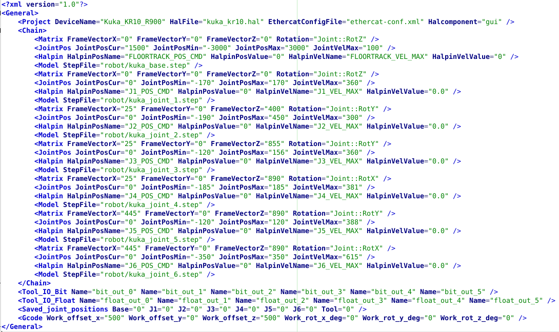

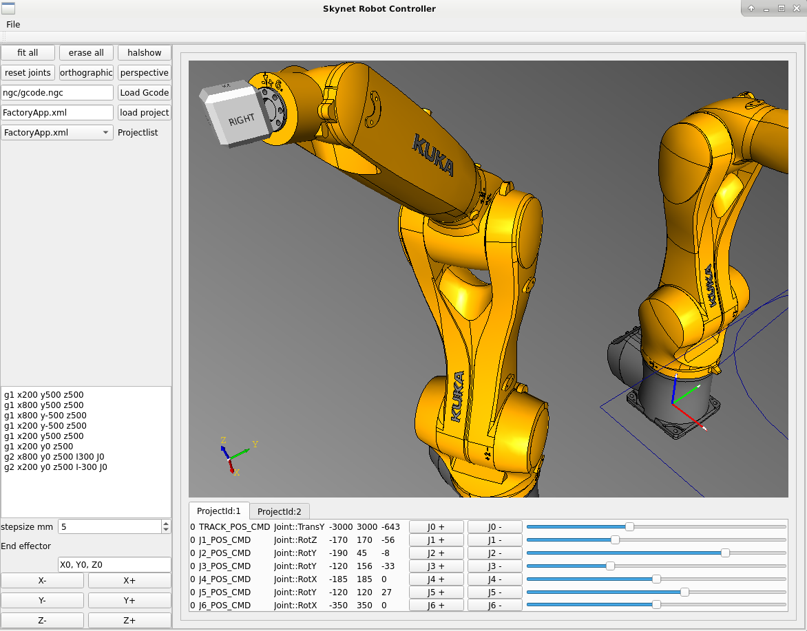

I integrated xml (project) file input. It reads in the machine stepfiles, the kinematic model, the hal connections etc.
Now it does not have to be a robot. It can be any machinetype.
The program is creating everything for the machine in a project array. Multiple machine's (projects) can be loaded at the same time.
A example of the xml file layout. The kinematics joints are build up by chains. This is a xml project file for one kuka robot.
I also integrated the doxygen document builder. It's a bit of work to get the doc's the desired output.
This is a example pdf output :
It's not as nice at the moment. But that changes when getting more experience with doxygen.
Also i added a 3d view button for display mode. It's called a view_cube by opencascade.
In the latest code, the opencascade kinematics are linked again. The kdl kinematics have to be linked.

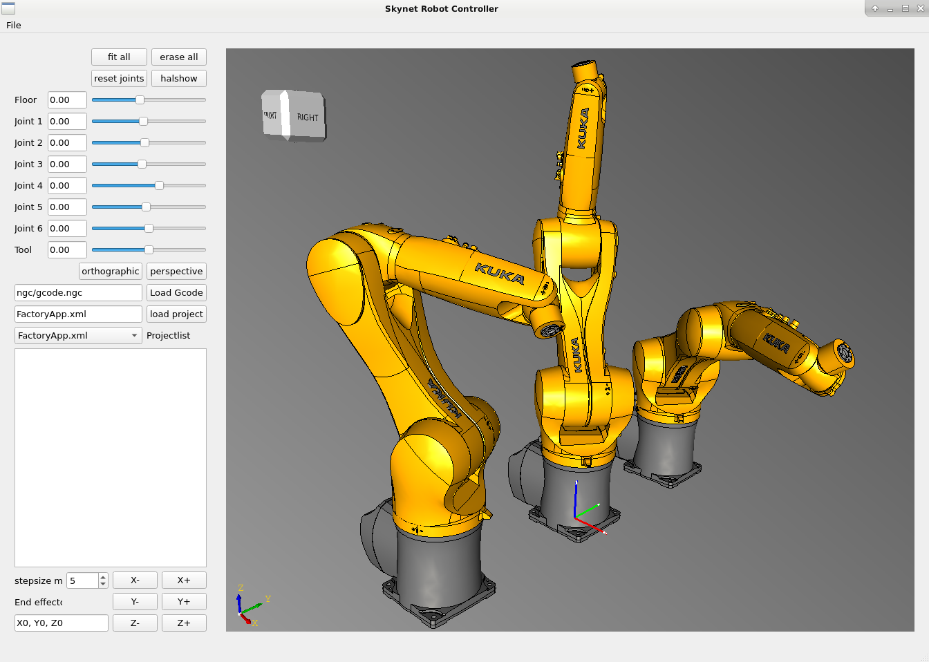

Now it's generating the joints automaticly. This picture is showing 18+6 joints.
6 joints each robot. each robot has a floortrack joint and a extra tooljoint.

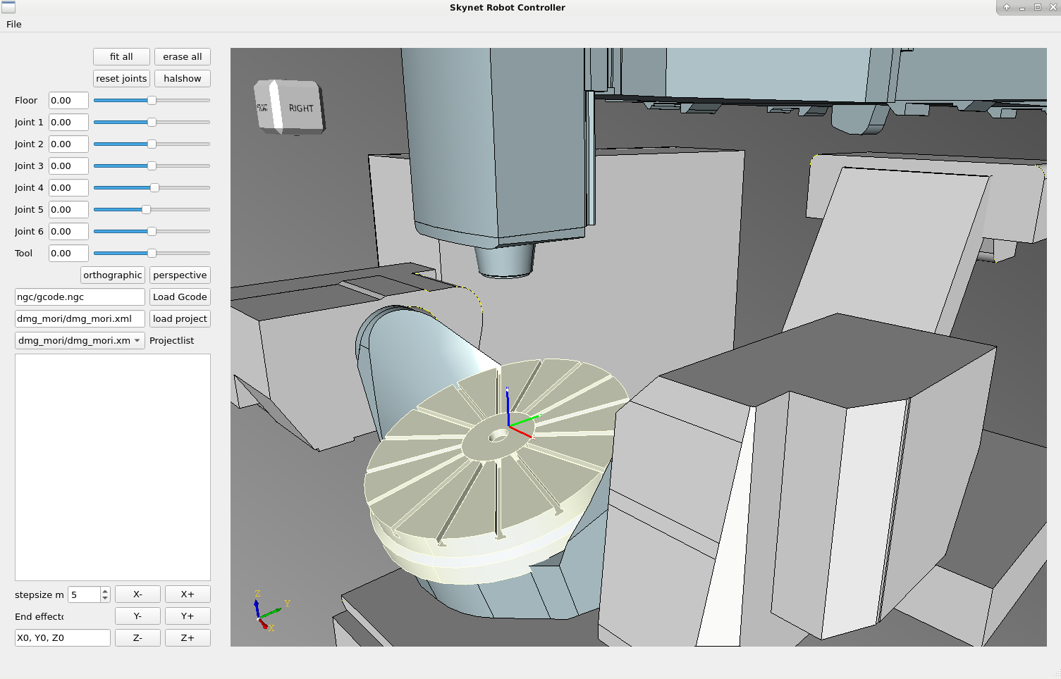

I have done a quick test with a 5 axis dmg mori machine. I have the rotary table connected to the model.
But i realize now, the machine has 2 kinematic chains.
An xyz axis (kinematic chain 1)
An 4th and 5th rotary table (kinematic chain 2)
Somehow i have to make a solution that one machine may have more then one kinematic chain.
And then hopely code something that the euler angles of bot'h kinematic chain's can follow each other like a handshake.
Some work to do. Still having some problems with importing colors. Aii.

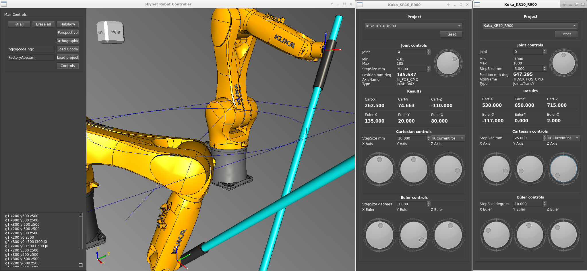

A tiny project update.
The inverse kinematics are finally working oke.
Coding a new controlpanel.
Soon i can do some interesting tests with linuxcnc.
One of the first test would be :
If i take a 3 axis linuxcnc setup and load a gcode. Linuxcnc will send the motion commands as normal to hal.
The robot can do this job realtime while reading the hal values.
When we read a g2 or g3 for plasma cutting, we can do a tool angle correction to neutralize the plasma cut angle. (euler angle).
Soon there is a lot possible, i hope.

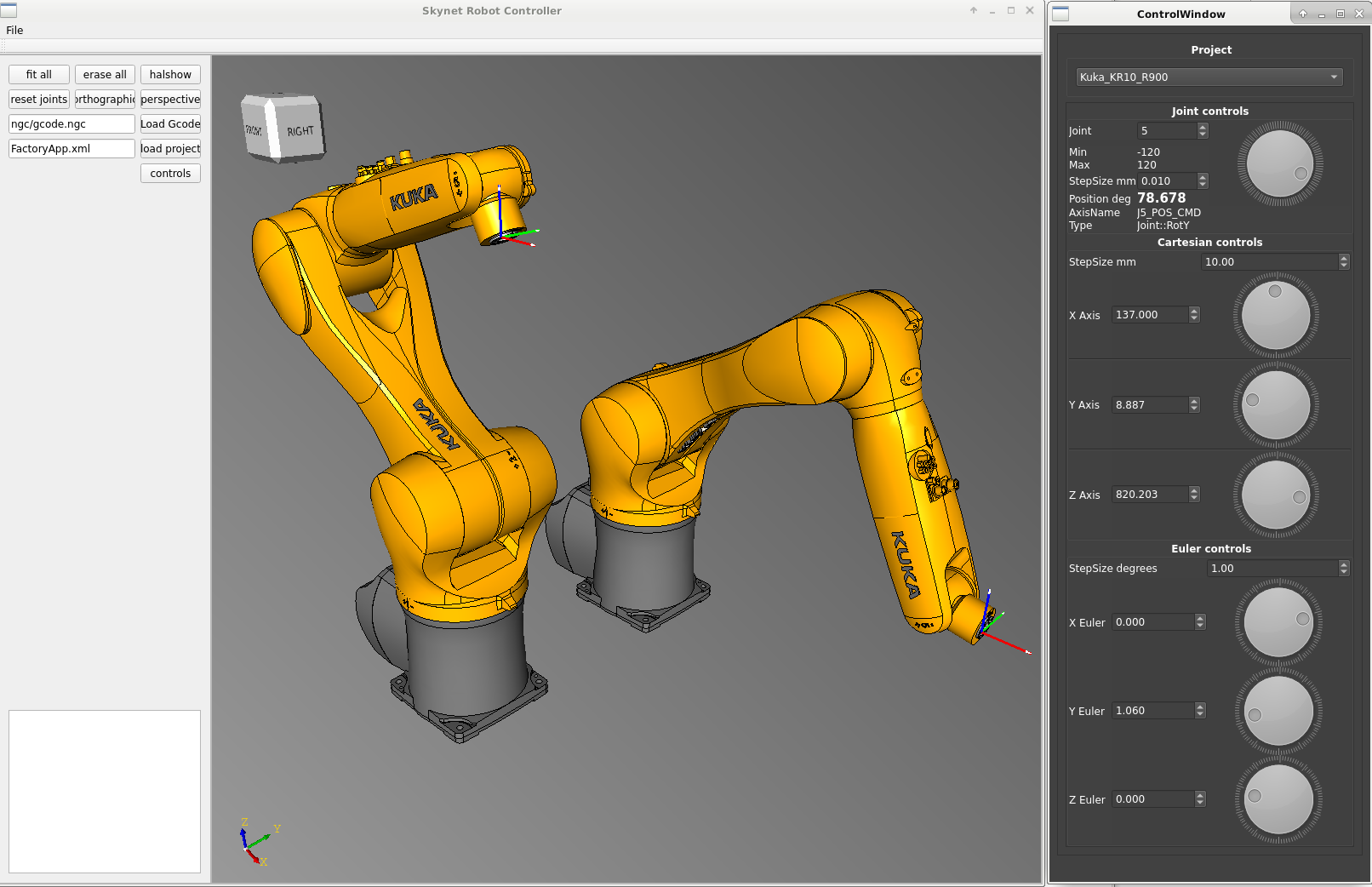

Today i worked on the program. Now the most of the controls are working.
The robots can do forward + inverse kinematics + rotate about end effector
with the euler angles.
I have solved some tiny code mismatches.
We are almost at the point to automate the robot positions with a cnc program. But first they must end the light saber battle.

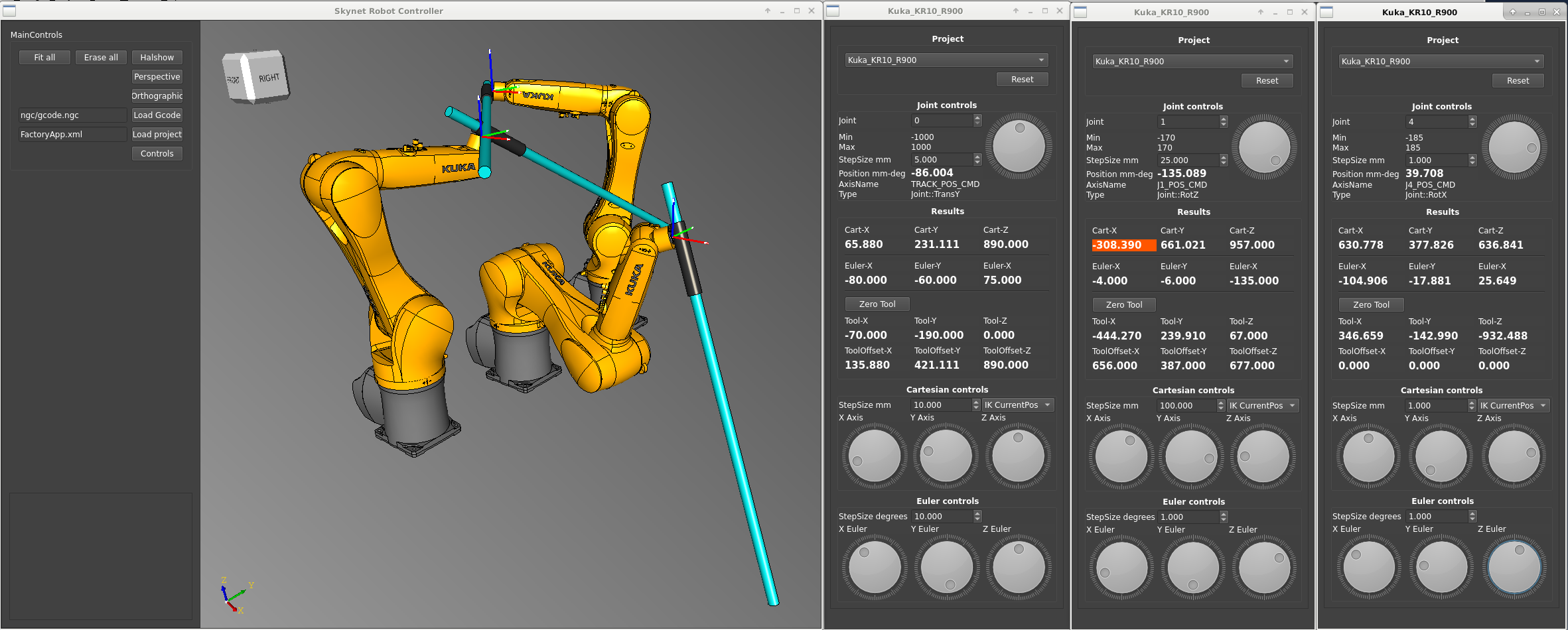

Hi Arciera,
Nice robot.
I have studied the robot kinematics in lcnc. Once there was a professor that made a paper about lcnc with a robot. I studied this too.
Yes in lcnc you can have that kind of situations.
Dewey Garrett's switch kins branch does that.
Ahh. I did not know that. Thanks for this info.
This code uses the KDL coronos kinematics library. This is a advanched kinematics library. In the beginning i did not understand how to use it. But step by step everything became clear.
In my case it uses joint limits, in cartesian and joint mode. It does not matter what kind of robot or machine you use. Everything works.
It's a dynamic plug and play chainsolver. I have made a extra option for the solver. It can calculate Fk and Ik from initial position or last known position. This is sometimes handy when a robot is on a track of the robot is working behind his back.
The reason that i did not use the lcnc build in kinematics and tk visualisation is that it is a kind of very limited and outdated.
With respect to the makers.
If you are interested? what kind of robot application do you want to realize? Is it pick and place or is it cam 3d?
and will not foresee the joint limits violations.
To check if there is a problem, a simulation check is needed. Vericut does this too. The opencascade (this is the cad interface) can
also do collision detection while simulating. For the future, there is a lot possible. You only have to code it, and that takes time and some knowlegde.
In global, the most difficult item's are done. Hal realtime tooks some time, Opencascade, KDL, Xml, Doxygen, etc tooks time.
Now it's almost time to code straight ahead all the solutions we need. It's piece of cake now.
(joint mode to avoid the singularities in the genserkins kinematics).
Haha. I am thinking about "The Singularity" for some day's now.

Hi Aciera,
Another thing I found difficult to implement is movements in tool coordinates. Linear motion is fine but rotations around Tool-X -Y- Z (A,B,C) I found difficult as with euler-angles the sequence of operations is important because of the matrix multiplications. I tried to use quaternions instead but it did not seem to make a difference.
The matrix multiplixations are in fact quite easy to do with KDL and OpenCascade. In fact i do the FK (forward kinematics) twice at the moment.
In code it's like matrix_a * matrix_b in a certain sequence.
I do the matrix multiplixations in opencascade for the step models. Then in kdl it is done a second time and shows the end effector drawing. This is a nice setup, because the opencascade checked the kdl setup and visa versa. If the end effector dwawing is not at the toolcenter, there is something wrong defined in the xml setup file.
Using euler xyz, this is the easyest to work with and to remember how it works. Things like pitch and yaw and roll are not easy to remember for me. The euler angles i can tell right away if i see the robot setup.
I also had a look at ROS which I think might actually use the same kinematics library you use. Yes i think it's the same.
But there is another famous lib for kinematics. I never used ROS, i have seen it on youtube.
as I will need some kind of code to program the movements of the refitted robot I still think LinuxCNC is the way to go.
I don't know what is the best. If you have studied them all, you can make a review. I even don't know why i am coding this because
i have no robot at the moment. I think it has to do with interests.
The red alarm is a kinematic limit... Aiii
